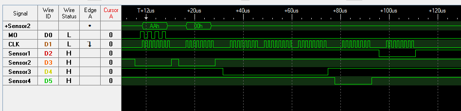

  • Are you trying to do something like this?
     The code looks like this:

        while(SSIDataGetNonBlocking(SSI0_BASE, &pui32DataSensor1[0]))
        // send a 0xAA to sensor 2
        pui32DataSensor2[0] = 0xAA;
        writeReadSensor(SENSOR2, 1, pui32DataSensor2);
        // read a byte from sensor 2
        // read 3 bytes from sensor 3
        writeReadSensor(SENSOR3, 3, pui32DataSensor3);
        // read 1 bytes from sensor 4
        writeReadSensor(SENSOR4, 1, pui32DataSensor4);
        // read 1 bytes from sensor 1
        writeReadSensor(SENSOR1, 1, pui32DataSensor1);
