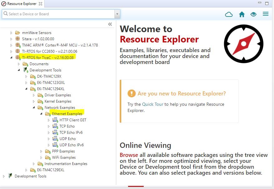

     If you want multi-threading support you better use the OS to manage your threads. I can't think of a proper way to manage multi-threads without the OS. There are many TI-RTOS examples you can reference. The TI-RTOS has its now TCP stack called NDK.
     I will suggest you look at below references.
    For TI-RTOS trainings go to below link. You will find both the video and PDF training slides/examples
    For TI-RTOS examples for TM4C129 you can use the TI Resource Explorer and see many examples. Below screenshot shows some Ethernet examples.
