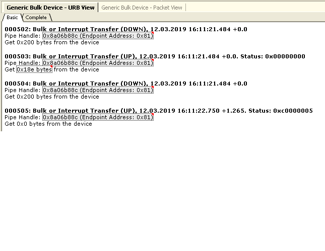

    Below is the results of the USB analyzer points of EP1 random close. The playback of the log file 4 (Bulk Stream1) indicates me unplugging cable few times to restart the connection for random code 0x5 events.

    The log really don't show anything but the host did not respond to the last request for 200 bytes, 0xC000.0005 common failure code. Out (UP) end pipe could not send requested packets since it abruptly aborts the pipe. At times suspect electrical disturbance is even worse but the OUT end pipe never aborts and frequent intermittent aborts at other times of high AHB activity. If I time the USB re-connect just right the OUT end pipe stays connected for extended periods (minutes) before aborting. If NVIC is not busy with PWM0 pends the OUT end pipe stays connected for hours and rarely aborts but has been detected aborting non the less.
    The real question remains how is INT58 vector not calling the registered handler and checking USBIS status flags configured in (usbdenum.c)? The bulk device driver (usbdenum.c) appears to have originated TM4C123 MCU and later tweaked to work with TM4C1294.
