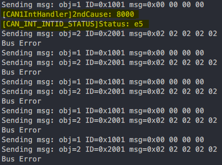

Here is a snippet of my Serial COM port.

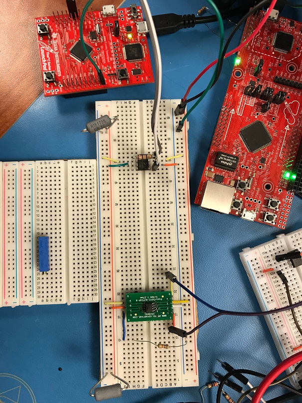

Here is the picture of my setup (I am using one SN65HVD1050 and one MCP2551)
From the COM port, I can see that the interrupt never happen when the message Object 1 is sent. So it results in BUS Error.
How should I fix this issue of my CAN bus?

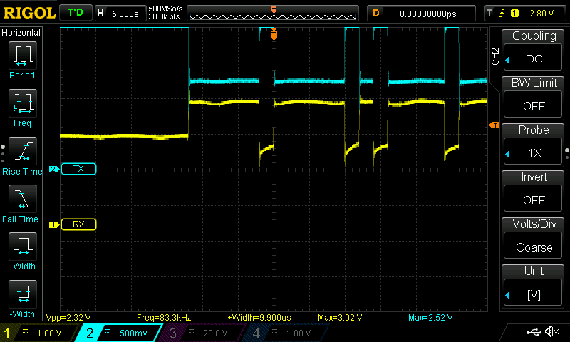

  • The '5' of the status 0xE5 is indicating a bit '0' error. That means the TM4C CANTX pin was driving a 0 (dominate), but the CANRX pin still saw a high (recessive). This implies that there is an issue with your hookup to the either the CAN transceiver or the bus itself. Using an oscilloscope or logic analyzer compare the CANTX pin to the state of the CAN bus.
  • Hello Bob,
    Thanks for a quick response. There are a few progression, however, I have some concerns that still need to clear up.
    Below are the changes from last post
    1. I used another TM4C129 instead of TM4C123 with the simple RX code.

    2. I have to call out CANIntRegister(CAN1_BASE, CANIntHandler) explicitly and make a prototype of that function inside of the startup_css.c file.
    Here is the image of my scope
    For some reasons, the CANBUS works now. On the receiver side, the interrupt never reached the transmitted done or showed any error beside 0xE5. Now if there is no receiver module on the bus, it would show Error Message as 0x63.
    Now are some concerns/questions that I have
    1. What is the error code 0x63? Is it an expected error code when there is no received on the bus?
    2. When I trigger to send the message every 500ms I saw the status code of the interrupt change from 0x48 to 0x08. With my research I believe that the 0x08 means CAN_STATUS_TXOK. Correspondinly, on the Receiver side, I saw the interrupt status is 0x10 which is CAN_STATUS_RXOK. What is 0x48?
    3. When I don't put any delay in the while loop, I received the "CAN MESSAGE LOSS DETECTED". Is this normal in CAN communication? I pumped the delay to 50ms then the message rarely happened. How should I best handle CAN communication to ensure the data is good?
    4. What is your recommended CAN analyzer?
    Alex
  • The status register bits are described on page 1381 of the datasheet. The status of 0x63 means (LEC = 3) no acknowledge was received. That is to be expected if there are no other nodes on the CAN bus. 0x40 of the 0x48 is the warning flag.
    Hau Tran said:
