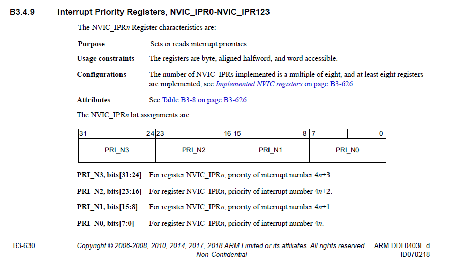

    B3.4.1 NVIC operation
    • NVIC interrupts are prioritized by updating an 8-bit field within a 32-bit register (each register supporting four interrupts). Priorities are maintained according to the ARMv7-M prioritization scheme.
    Maximum supported priority value
    The number of supported priority values is an IMPLEMENTATION DEFINED power of two in the range 8 to 256, and the minimum supported priority value is always 0. All priority value fields are 8-bits and if an implementation supports fewer than 256 priority levels then low-order bits of these fields are RAZ.
    Table B1-6 Relation between number of priority bits and maximum priority value
    Number of priority bits          Number of priority levels       Maximum priority value a
    3                                              8                              0b11100000 = 224(0xE0)
    4                                              16                           0b11110000 = 240(0xF0)
    5                                              32                            0b11111000 = 248(0xF8)
    6                                              64                            0b11111100 = 252(0xFC)
    7                                              128                         0b11111110 = 254(0XFE)
    8                                              256                          0b11111111 = 255(0xFF)
    a. This value always corresponds to the lowest possible exception priority.

  • ARM Cortex M4 v7 reference PDF states NVIC supports 240 interrupts 256 levels of priority. It seems IntPrioritySet() configures some, not all priority group mappings shown ARM Cortex reference PDF table 6-1 . Point being 256 levels of priority are restricted to only 8 groups (REG58) does not even exist in ARM Cortex M4 v7 MCU? ARM reference manual does not indicate NVIC being restricted to 8 priority groups (0x00-0xE0) or 3 bit splits [7:5].
    ARM M4 v7 Interrupt Priority Register : 0xE000E400- 0xE000E4EC (NVIC_IPR0 - NVIC_IPR59) RW 0x00000000.
    Incomplete Tivaware priority range: [NVIC_PRI0 (0xE400) - NVIC_PRI34 (0xE488)].
    REG58:
    The PRIGROUP field indicates the position of the binary point that splits the INTx fields in the
    Interrupt Priority (PRIx) registers into separate group priority and subpriority fields. Table
    3-9 on page 171 shows how the PRIGROUP value controls this split. The bit numbers in the Group
    Priority Field and Subpriority Field columns in the table refer to the bits in the INTA field. For the
    INTB field, the corresponding bits are 15:13; for INTC, 23:21; and for INTD, 31:29.
    Where are INTA, INTB, INTC, INTD fields shown in Figure 3-9, bits 31:16 are for entry of intvect key value (0x0F5A)?
  • Modified post above as ARM system guide to NVIC indicates the binary split REG58 being the highest hex value in any single grouping.
    Also note ( INTA, INTB, INTC, INTD) above post are not shown in datasheet (REG58) seem to infer the NVIC table below should be referenced assigning any interrupts to specific groupings.
    It would seem priority grouping binary split (REG58) is incomplete when calling IntPriotryGroupingSet(). Seemingly relates to high NVIC latency (>400µs) when SS2 trigged via GPIO from priority group (0x40) samples signals resulting group (0x20), the lower priority groups interrupt handler must be delayed so application targets latency window as NVIC incorrectly preempts active pends in the lower priority group. There is no way on earth TM4C1294 NVIC should be preforming so oddly for several peripherals pending active edge or pulsed interrupts from Tivaware prioritized interrupts groupings.
