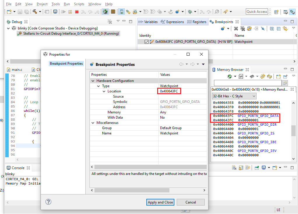

CCS/TM4C1294NCPDT: Hardware Watchpoint Not Being Triggered
Part Number: TM4C1294NCPDT
I'm having trouble getting a hardware watchpoint (breakpoint) to trigger.  I'm trying to do so on the blinky example.  The example simply toggles pin 0 of port N to blink the LED.  As shown in the screenshot below, this is at address 0x400643FC.  By all accounts I have the watchpoint configured properly as shown below, however as the LED blinks on/off the program never breaks.  Anyone have any ideas?
  • Hi Terence,
    Please refer to the datasheet on the Data Register Operation for GPIO module for details. Basically, each 8-bit GPIO port has 256 combinations. Each combination is memory mapped to an unique address to facilitate bit writing as Cortex-M4 core does not naively support bit writing. The offset 0x3FC would mean that you are writing to all 8-bits in Port N.
    Please also refer to the below post which may also help.
    e2e.ti.com/.../2880239
    Another way to understand is to look at the how GPIOPinWrite. See below how the ui8Pins being shifted by 4 as an offset address.

    HWREG(ui32Port + (GPIO_O_DATA + (ui8Pins << 2))) = ui8Val;
  • Thank you, Charles. I think I understand now. I need to set my watchpoint address to 0x40064004.
