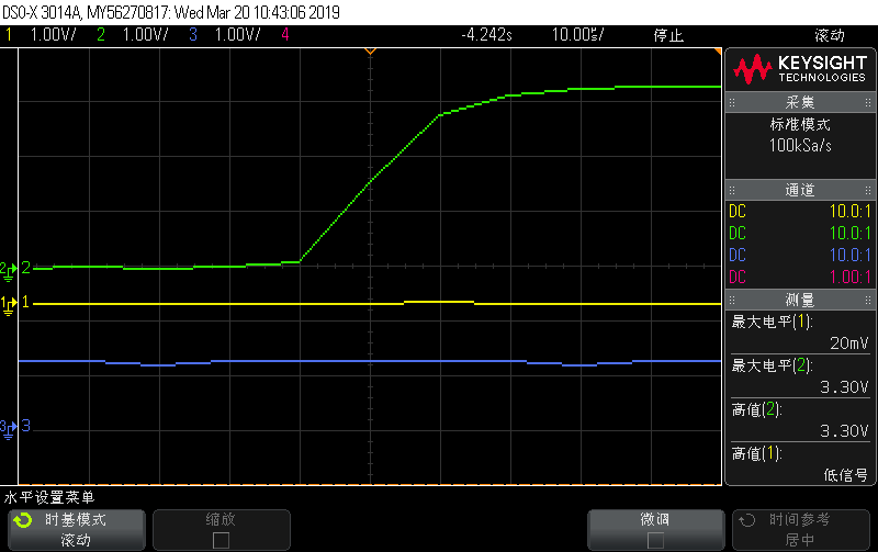

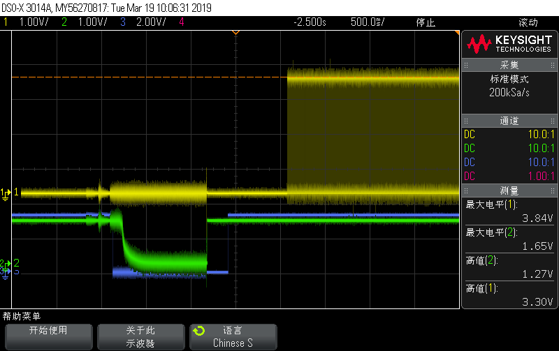

Customer faced an issue, few times (1 or 2 from 10 times), application code can't run after power up.
The sequence of the power up is:
1) First 1.2V and 3.3V building; reset pin is hold low;
2) 200ms later, reset pin is released to high;
3) After 700ms, application output a 1KHz signal.
External crystal is OK.
What could be the issue?
The reset signal on the pin is like line 2, it takes 26us from 0 to 3.0v:
Thanks a lot.
