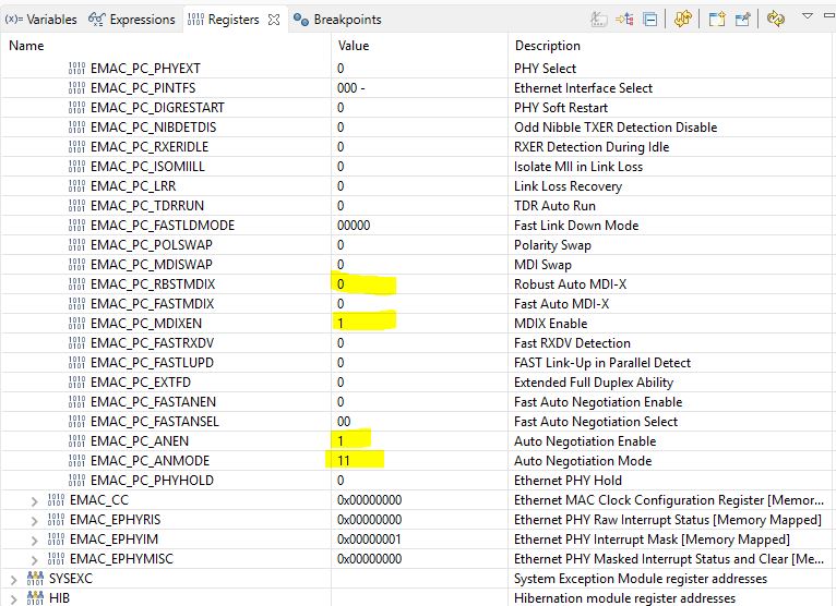

    I was able to get link with
    EMACPHYConfigSet(EMAC0_BASE, EMAC_PHY_TYPE_INTERNAL | EMAC_PHY_INT_MDIX_EN | EMAC_PHY_AN_100B_T_FULL_DUPLEX);
    but I can see in the PHY status and BMCR registers that the auto negotiation is enabled and completed. So the devices settings are not FORCED which was the goal in the first place.
    Or does the auto-negotiation always need to be ON for auto MDI-X to work?

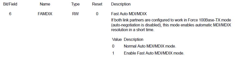

     The datasheet says "Auto-MDIX can be used in the forced 100Base-TX mode. Because in modern networks all the nodes are 100Base-TX, having the Auto-MDIX working in the forced 100Base-TX mode resolves the link faster without the need for the long Auto-Negotiation period."
      With the above statements, it seems the datasheet is suggesting Auto-MDIX (my interpretation is just normal Auto MDI/MDIX) rather than robust MDIX will resolve the link time. It also qualifies the statement by saying "without the need for the long Auto-Negotiation period". This seems to imply that Auto-Negotiation is also turned while the Auto-MDIX is enabled.
      Honestly, I don't have the PHY expertise to explain why the link time is taking 90 or 10 seconds. I wonder if you try with other models of hubs will you see any differences? How about changing the cable?
     Can you try Fast Auto MDI/MDIX mode? Will you see difference?

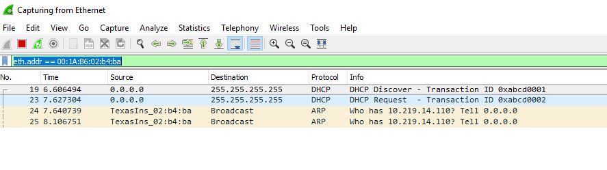

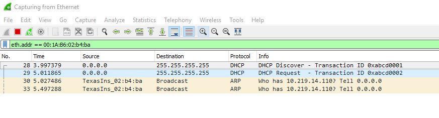

     I tried both the below configurations on the TivaWare enet_lwip example and I couldn't find much difference in terms of the link time. I have the LaunchPad running the enet_lwip connected to a switch. I don't have a hub.
    /* the first one is what is originally used in the example */
    #define EMAC_PHY_CONFIG (EMAC_PHY_TYPE_INTERNAL | EMAC_PHY_INT_MDIX_EN |  EMAC_PHY_AN_100B_T_FULL_DUPLEX)
    /* The second one is what you used to force robust MDIX */
    #define EMAC_PHY_CONFIG (EMAC_PHY_FORCE_100B_T_FULL_DUPLEX | EMAC_PHY_INT_ROBUST_MDIX | EMAC_PHY_INT_MDIX_EN)
    Below are the results I found.
    Using EMAC_PHY_FORCE_100B_T_FULL_DUPLEX | EMAC_PHY_INT_ROBUST_MDIX | EMAC_PHY_INT_MDIX_EN
    Using EMAC_PHY_TYPE_INTERNAL | EMAC_PHY_INT_MDIX_EN |  EMAC_PHY_AN_100B_T_FULL_DUPLEX
    As you can see in both the wireshark captures, the time from DHCP Discover until the beginning of the ARP is about 1 second. Can you try with a switch and see if you see any differences between the two configurations?
    In either case for me, it was pretty fast between Waiting for link and Waiting for IP address.
