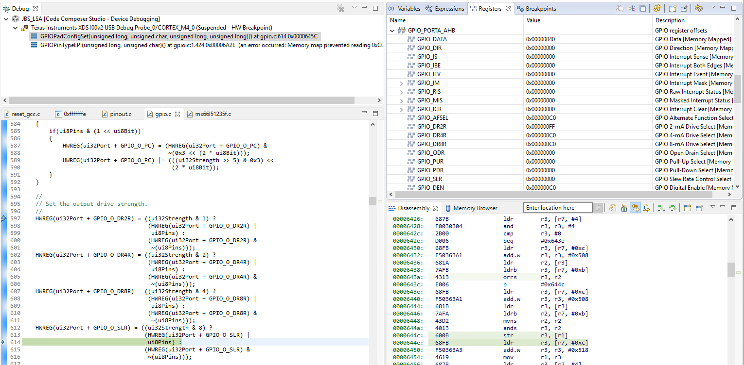

  • It seems that by running the EPI drive strength set up twice solves the problem of using the 2 new SDRAMS. The code change is inspired by the code example in C:\ti\TivaWare_C_Series-2.1.4.178\examples\peripherals\lcd\sdram.c and having the comment:
    // Workaround - call these APIs again for to ensure that the correct
    // drive strength is selected.
    Is this behavior documented in an errata or anywhere else ?
  • Additional to double programming of register findings it seems strange that the Tivaware execution of the EPI setting end up with all drive bits set, 2mA,4mA and 8mA, as in the users guide in the 4mA drive description (GPIODR4) it is mentioned that 'Setting a bit in either the GPIODR2 register or the GPIODR8 register clears the corresponding 4-mA enable bit. The change is effective on the next clock cycle.' See attached CCS screen dump. It should only be one of the drive bits that should be set and the other bits cleared. In the Screen shot it's the port A bits 6 and 7 that are used for EPI.
  • Have anyone else seen this behavior or found documentation explaining what we see ?
