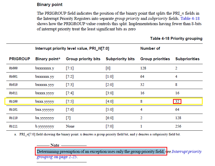

It would seem ARM Cortex M4v7 programmers guide priority bit fields are missing from how TI has implemented TM4C1294 NVIC Priority/Sub priority groups.
Specifically the sub priority fields (0-7) for each group priority (0-7) in a 3 bit split configured REG58 (APINT) are missing from datasheet. ARM Cortex M4v7 NVIC supports up to 256 priority levels for each interrupt. The sub priority bit fields (nibble) for each primary grouping (0-7) interrupt source that ARM programmers guide shows are missing in TI datasheet. Datasheet Table 3-9 row 1 (0x0-0x4) is incorrect to suggest only 1 sub priority can exist in 3 bit split as that would violate ARM Cortex M4v7 (proven) NVIC architecture.
For clarity of issue I added grouping bit split (Notes) M4v7 NVIC is capable to decode next to the Tivaware (hw_nvic.h) NVIC_APINT defines. It would seem the interrupt sub priority interrupt fields 3 bit split for 0x00000200  [2:0] Tivaware does not set sub priority levels, 8 interrupt priority level bits (0x0-0x7), e.g. priority groupings 0x00-0xE0. ARM M4v7 Core NVIC supports primary priority groupings and levels of interrupt priority within this case 0-7 groupings 0x0-0xE0. That is not being configured by IntPrioritySet() which only sets the Sub priority interrupt bit field to act only as a primary grouping and that will never work properly in M4v7 NVIC schema. It seems someone at TI has mistaken how NVIC works as ARM Cortex documents suggest it should.
We need 8 priority groups 0x0-0xE0 (5:3 split) with minimum 8 sub priory levels (0-7) within each grouping. It seems Tivaware IntPrioritySet() limits NVIC to 1 group with 8 sub priorities in conflict with table 3-9. It seems we can't make the call but one time to IntPriorityGroupingSet(2 or 4) again each one restricts us to only one group, not 8 separate groups as table 3-9 indicates.
Accordingly what seems to occur as a result of asserting higher priority interrupt groupings they incorrectly speed up lower priority tail chaining relative to the higher priority asserts with that group.

  • The ARM documentation is describing a feature that is not in the NVIC of the TM4C parts. The NVIC on the TM4C parts only uses the upper three bits to determine one of eight priority levels as described in the datasheet and the TivaWare Peripheral Driver Library User's Guide.

    TI did not change the ARM NVIC. ARM changed it. The TM4C devices were designed before the latest M4 NVIC was available. You are looking at the wrong ARM document. See: http://infocenter.arm.com/help/topic/com.arm.doc.dui0553b/DUI0553.pdf section 4.2.7.
    If you expand the NVIC portion of the register window and write 0xFF to one of the bytes of the NVIC_PRIn registers, you will see it reads back as 0xE0. Only the three most significant bits of the priority register are implemented in this NVIC. This is just as we documented in the datasheet and what is supported in the TivaWare drivers.
    If you require additional priority levels, or the use of sub-priorities, you need to get an M4 from a different supplier.

  • Let me try explaining the NVIC.
    ARM created an NVIC that supports a configurable number of bits, up to 8, to determine the priority and sub-priority. In the TI implementation for the TM4C parts, we implemented the NVIC with 3 bits for the priority level, bits 7 through 5. Bits 4 through 0 always read 0. That gives you 8 different priority levels. Those 8 levels can be configured by the NVIC_APINT register to be 8 priority levels with each level having a single sub level. (This may be what is confusing you. A single sub level is saying that within that priority group, all of the interrupts are at the same level. Just like not having a sub-priority.) The other three options are 4:2,  four priority groups and two sub-priority groups; 2:4, two priority groups and four sub-priority groups; or 1:8, all interrupts at the same priority level, but 8 different sub-priority groups.
    When multiple interrupts are pending, interrupts from a lower priority group number will go first. They will preempt an interrupt service routine with a higher priority group number. If two pending interrupts are in the same priority group, the request from the lower sub-priority group number will be taken first. An interrupt request will not preempt an interrupt routine that is in the same priority group even if its sub-priority number is lower.  When two interrupt requests are in the same sub-priority group, the request with the lowest exception number will be taken first.
    So what does that mean. In the default configuration (8:1), An interrupt with a lower priority number can preempt an interrupt service routine from an interrupt at a higher priority number. Interrupts at the same priority are executed in order of the exception number, the lowest number being the highest priority. The exception number can be found by looking at the hw_ints.h file in TivaWare.  For this part, GPIOA is number 16, GPIOB is number 17, GPIOC is number 18, GPIOD is number 19 ... . By default, all are at priority level 0. If interrupts from GPIOA and GPIOB come at the same time, the interrupt from GPIOA will be serviced first since it has the lower number. That interrupt routine will finish and tail (not return to the main code) into the interrupt routine for GPIOB.
    Now lets say that we want to make GPIOB a higher priority interrupt that can preempt a GPIOA interrupt routine. Then call:
        IntPrioritySet(INT_GPIOA, 1u << 5u);
    This will set GPIOA interrupts to priority level 1, leaving GPIOB interrupts at priority level 0. Note that we have to do the "<< 5" because the three bits implemented for priority are bits 7:6.  Of course you could use a define to make the "1u << 5u" more readable such as:
    #define INT_PRIORITY_LEVEL1 (1u<<5u)
    Now lets say I want GPIOC to be serviced before GPIOA, but not to preempt it. However, I still want GPIOB to preempt either one. This is where I use sub-priorities. I used #define for readability, but notice that GPIOA is set to level 3, GPIOC is set to level 2 and GPIOB is left at level 0. Since the least significant bit is for sub-priorities, levels 2 and 3 are now in the same priority, but different sub-priorities:
    #define INT_PRI1_SUB0 ((1u<<6u) | (0u<<5u))
    #define INT_PRI1_SUB1 ((1u<<6u) | (1u<<5u))
        // 2 bits priority, 1 bits sub-priority 4:2
        IntPriorityGroupingSet(2u);
        IntPrioritySet(INT_GPIOA, INT_PRI1_SUB1);
        IntPrioritySet(INT_GPIOC, INT_PRI1_SUB0);
     I hope this clears it up.

    To increase priority control in systems with interrupts, the NVIC supports priority grouping. This divides each interrupt priority register entry into two fields:
    • an upper field that defines the group priority
    • a lower field that defines a subpriority within the group.
    Only the group priority determines preemption of interrupt exceptions. When the processor is executing an interrupt exception handler, another interrupt with the same group priority as the interrupt being handled does not preempt the handler,
    "That has been proven untrue as Edge counter exception was disabled and still allowed re-entry before it was re-enabled 500ms later by TBILR load value in a conjoining context, GPTM0B with GPTM03 Oneshot also 1st synchronized."
    If multiple pending interrupts have the same group priority, the subpriority field determines the order in which they are processed. If multiple pending interrupts have the same group priority and subpriority, the interrupt with the lowest IRQ number is processed first.
