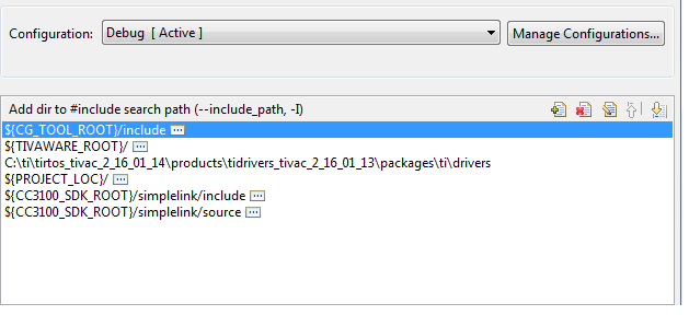

I managed to run the tcpEchoCC3X00 and httpgetCC3100 from tirtos_tivac examples. I was able to import, resolve all issues and access my tm4c via WiFi. I am now trying to run examples related to http://www.ti.com/tool/TIDM-TM4C129XWIFI, I downloaded the wifi_node_ap_tirtos and wifi_node_station_tirtos example projects. I adjusted the links to point to my versions of XDC tools, compiler, TI-RTOS and CC3100-SDK. Project compiles, however, I get the following warnings:
My link directories:
IoSetTimer and Decimal2String are defined in io.c file which is a part of wifi_node_ap_tirtos example. There is an associated io.h header file which is included throughout files in the project. Unfortunately, this io.h file doesn't provide function declarations which could resolve warnings.
Once I run this code on the target it gets stuck in LOOP_FOREVER() in line 709 in main.c file. This happens after returned value from configureSimpleLinkToDefaultState() is less than 0.
I haven't modified a single line in the code. I just copied files to workspace project and resolved the links as shown above. I saw the following post:e2e.ti.com/.../774462 on this issue but user was trying to use CC3120 with given examples. I work with CC3100 and TM4C1294XL which are meant to be used in this example project.
