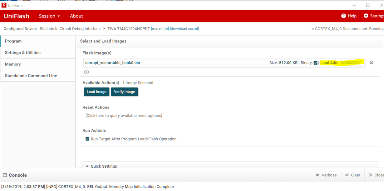

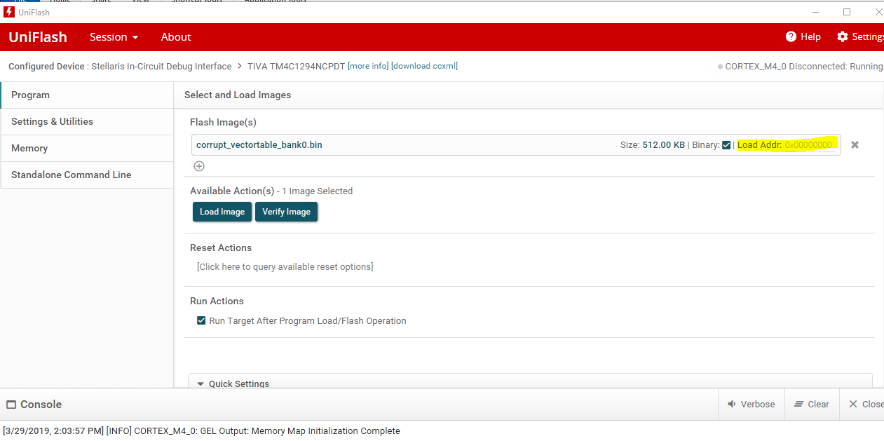

  • Regarding the TM4C123 board (EK...) is there a way to upload the binary to a different section using linux lm4flash?
    github.com/.../lm4tools
    Because i already tried the boot_usb example from dk-tm4c123g and changed the Makefile PART and -DTARGET_IS_.. Then i am supposed to also flash the boot_demo1 or 2. But i guess the binary for the bootloader should be flashed in 0x0000 address and the application codes in 0x4000 or something like this.
    I saw that lm4flash exe for windows has a possibility to change the section area (program address offset)
  • Sorry, I am not familiar with the linux lm4flash. The fact that it is on github instead of on ti.com makes me suspect that it came from the user community, not from TI. Here is another thread that discusses that tool:
    https://e2e.ti.com/support/microcontrollers/other/f/908/t/542213
    I am not a linux user, but in the Windows version of UniFlash, I see the option of changing the base load address.
