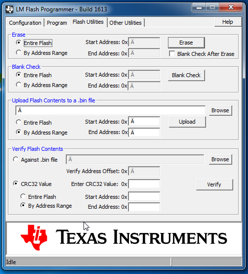

  • Hi Anamika,
    Can you try doing a Entire Flash Erase using LM Flash Programmer.
    -kel
  • Hii Markel
    I have tried LM Flash Programmer and its successfully displaying flash program erased.
    But when we try to dump the new code its not dumping ,still old program is running.
    Problem is here that, its permanently goes into Hibernation.Kindly give any suggestion so that I can proceed.

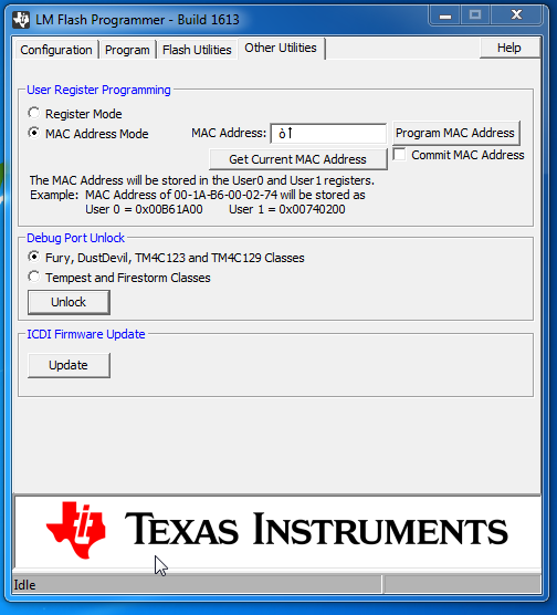

  • Did you try using LM Flash Programmer to "Unlock" the part? That will force an erase of the entire flash. It will also erase the non-volatile user registers which may contain your Ethernet MAC address. You will need to be able to assert RST- low while you power-on the device.

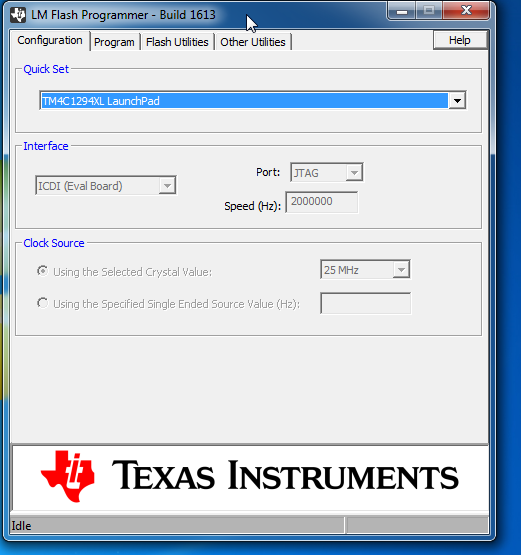

  • Hi Bob Crosby,
    You can go through below steps what I did
    1)Configuration  ---> Quick set (TM4C1294XL Launch Pad)
    2)In Program menu and flash utilities ,we didn't do any changes.
    3)In other utilities  ---> selected MAC address mode and selected Fury, Dust Devil, TM4C123 and TM4C129 classes.
    4)Finally I clicked on UNLOCK button after that
    - confirm with yes
    - on next MsgBox hold reset, connect
    - click ok, while still holding reset
    - release reset
    - power cycle board (and restart Flash tool?)
    Thanks & Regards ,
    Anamika.

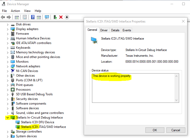

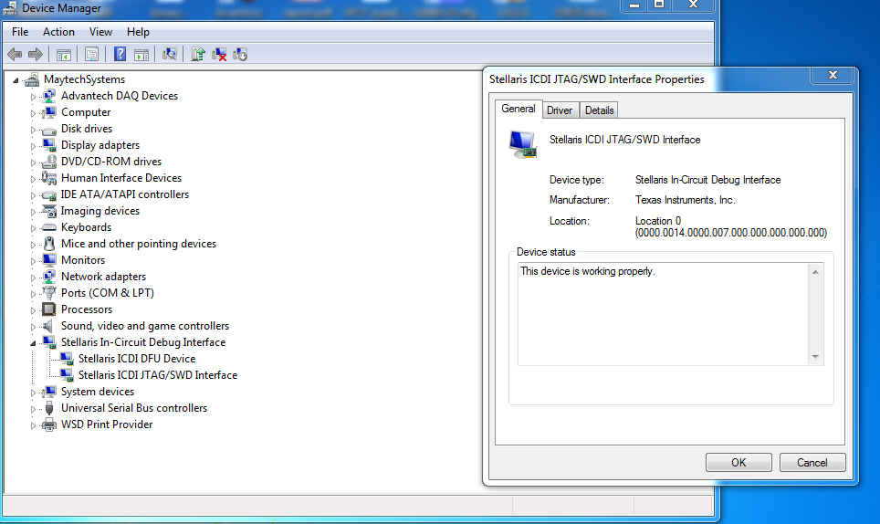

  • No, it is not necessary to update the ICDI firmware. You should not have gotten that error message. I question whether your ICDI is still properly working. If you open your Windows Device Manager with the EK-TM4C1294XL launchpad connecting the Debug micro USB port of the launchpad  to a USB port on the PC, does it look like the "Stellaris ICDI JTAG/SWD Interface" is installed correctly?
  • Hi Bob Crosby,
    Yes, there is no any wrong with Stellaris ICDI interface, it showing as like below....
    But I don't know why the flash is not erasing with LM Flash Programmer...I need urgent help sir...Will you please give me any suggestion...
