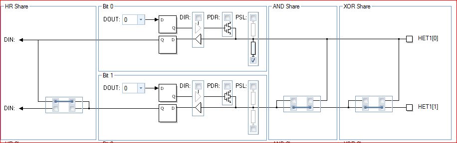

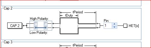

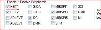

I am feeding a 100Hz/50% PWM signal on the pin 23 of TMS570LS3137 controller. The necessary driver and pin configuration is made but still not able to read the valid PWM freq and duty using the capGetSignal() function call. Kindly let me know how to resolve this issue. Below are the configuration setup for the capture input N2HET1[1]
I have tried with the similar driver setup for HET2[8] but it didnt work and the capGetSignal() read values for freq and duty are not valid. I am success with above configuration for N2HET1[4] and N2HET1[6] pins.
Appreciate for the early response and support. Thanks in advance.

  • Dear Miroslav,
    Thanks for the response, the issue is same but with different pin set, I am not sure which bit need to be changed. I feel the HR share is cleared in the configuration for HET[1]. With this configuration, the capture is still not working for me. Kindly suggest.
    /** - Set HET pins high resolution share */
    hetREG1->HRSH = (uint32) 0x00000000U
    | (uint32) 0x00004000U
    | (uint32) 0x00002000U
    | (uint32) 0x00000400U
    | (uint32) 0x00000100U
    | (uint32) 0x00000080U
    | (uint32) 0x00000020U
    | (uint32) 0x00000008U
    | (uint32) 0x00000004U
    | (uint32) 0x00000000U;
