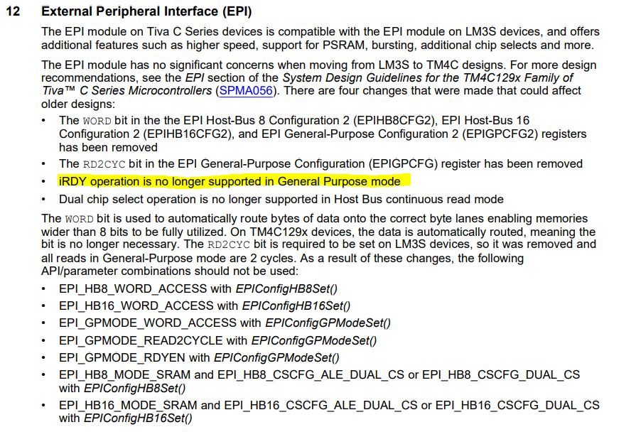

I would like to use the EPI of the TM4C1294NCPDT in General-Purpose Mode.
I am confused why the iRDY Input Signal for stalling reads, is not implemented anymore (as it was on the Stellaris LM3S9D90).
On the Data Sheet of the TM4C1294NCPDT on page 848 it says;
The configuration allows for choice of an output clock (free-running or gated), a framing signal (with
frame size), a ready input (to stretch transactions), an address (of varying sizes), and data (of varying
sizes).
Question: Is that an error in the Datsheet?, How can use an  Input Signal for stalling reads?
Kind Regards
    Yes, you are correct that iRDY is not implemented in TM4C129 for the General Purpose mode. However, the iRDY is mapped to EPIS032 in the Host mode if the RDYEN bit is enabled.

  • Hi Livio,
     Unfortunately, as I have mentioned in the last reply, per the TM4C129 datasheet the iRDY is not available in the General Purpose mode.  I understand that the iRDY signal is available and documented in the LM3S9D90 where it is mapped to the EPI0S27 pin.  Please refer to the "Transitioning from Stellaris LM3S to Tiva C Series MCU" app note http://www.ti.com/lit/an/spma049a/spma049a.pdf for details about the differences between the two MCU. Specifically about the EPI where it mentions the iRDY is not supported in general purpose mode.

  • Hi Charles
    Yes, that is clar now. Thanks for the additional dokumentation "Transitioning from Stellaris LM3S to Tiva C Series MCU".
    I am still wondering: Why is it suggested (in the MCU Datasheet) to use the general purpose mode for FPGA's connections, when there is no feedback/ready/waitrequest signal? Since the two most common FPGA's Bus systems (Avalon from Intel and AXI from Xilinx) are dependent on this signal.
