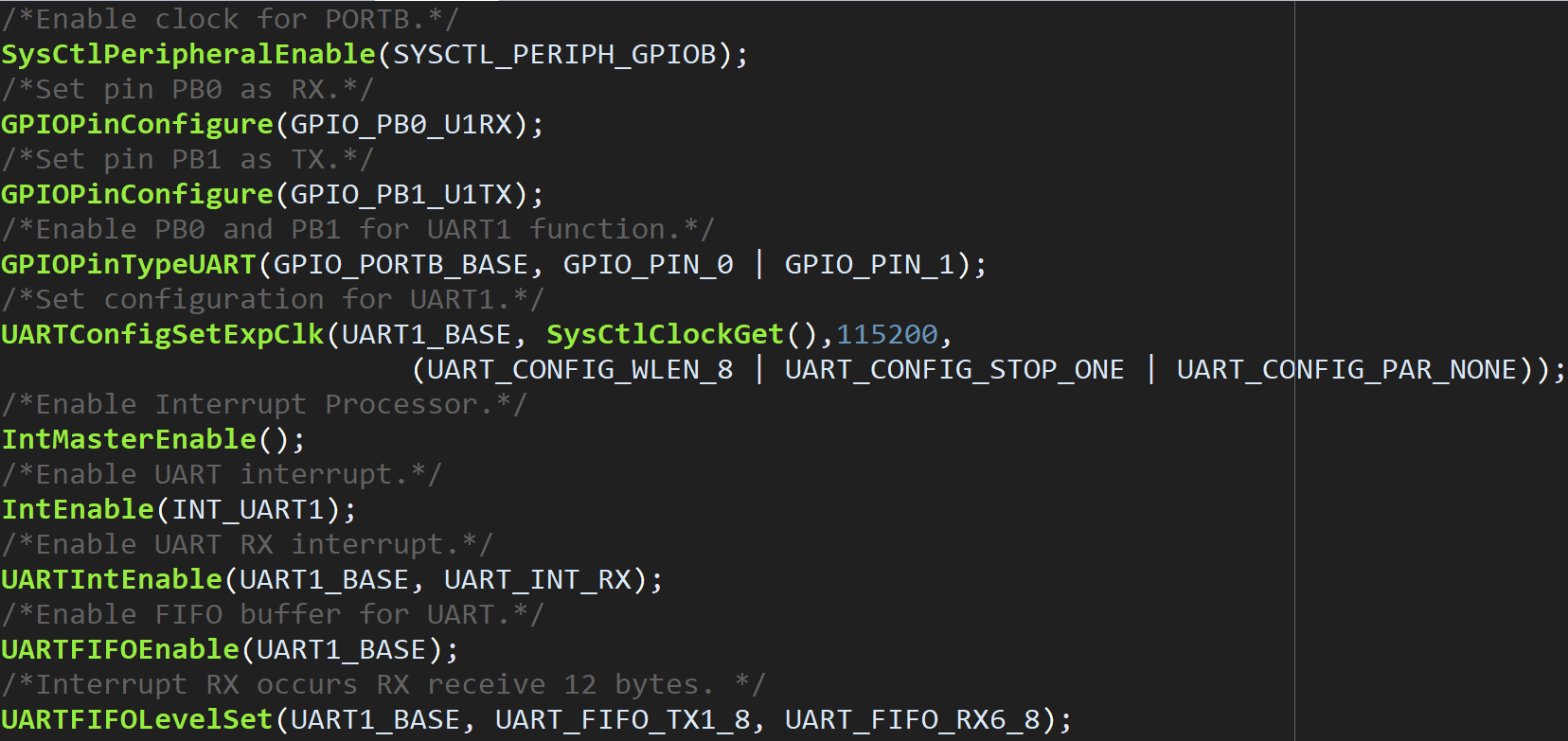

Hi all,
I am facing with a hard fault interrupt.

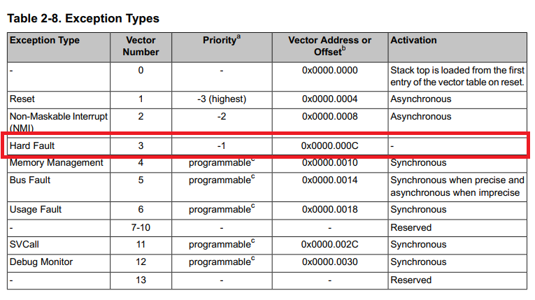

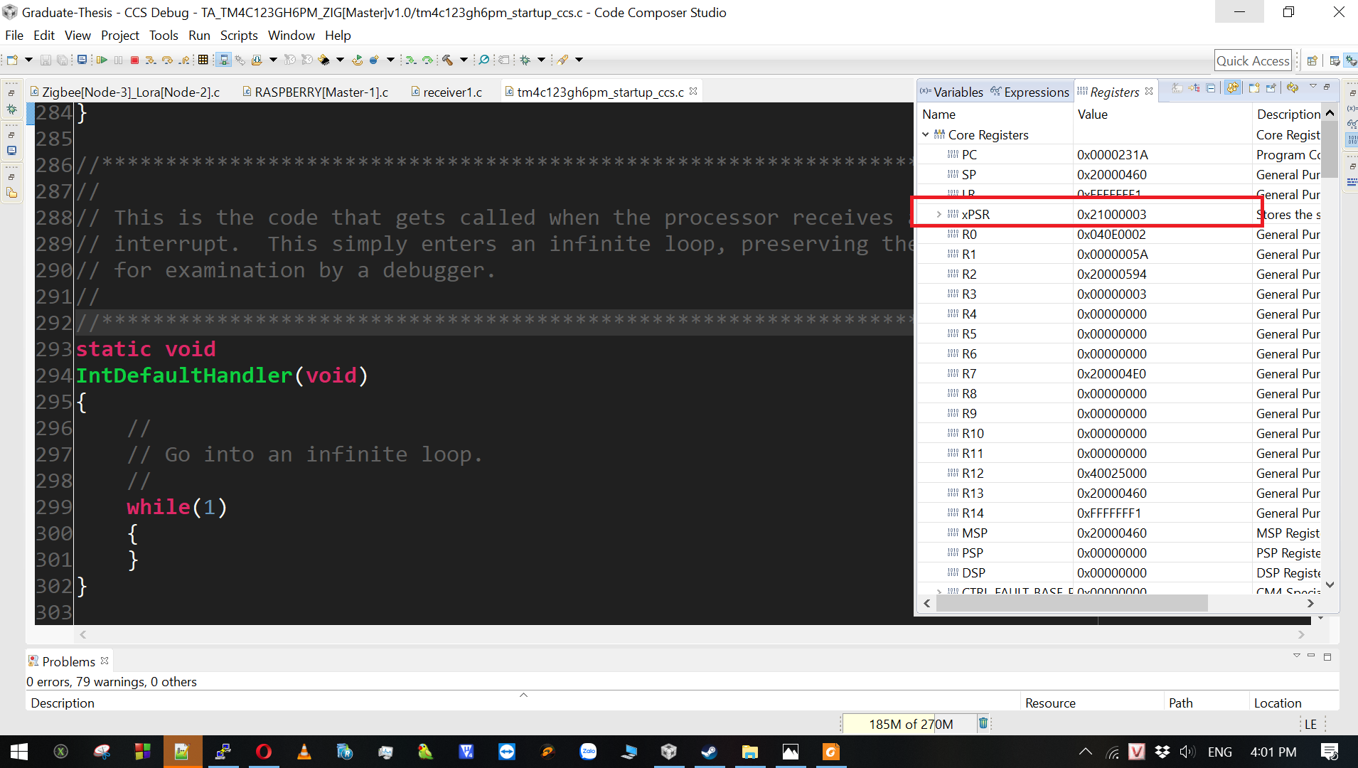

I use two interrupts in my program, UART 1 RX interrupt and UART 3 Interrupt. My program runs correctly in approximately 1 minutes and after that, it is halted.
Following the tutorial http://www.ti.com/lit/an/spma043/spma043.pdf , I found that it is Hard Fault:

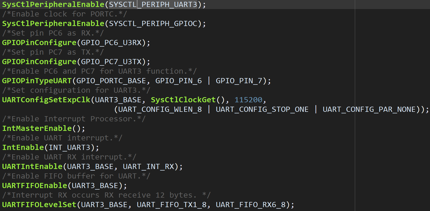

and here is the configurations of UART1 and UART3:
Could somebody please help me fix the problem. This is the first time I have faced this problem so I don't know how to deal with it.
Thank you for your time.
    Are you sure your UART interrupt handlers at startup_ccs.c are correct?
    -kel
  • Yes, Of course.

    If you have a hard fault then it should have taken the FaultISR() ISR instead of IntDefaultHandler() as shown in your screenshot. If your CPU is looping in the IntDefaultHandler then it means you did not have a ISR vector defined. They interrupt may have come from some modules other than the UART1 and UART3.
