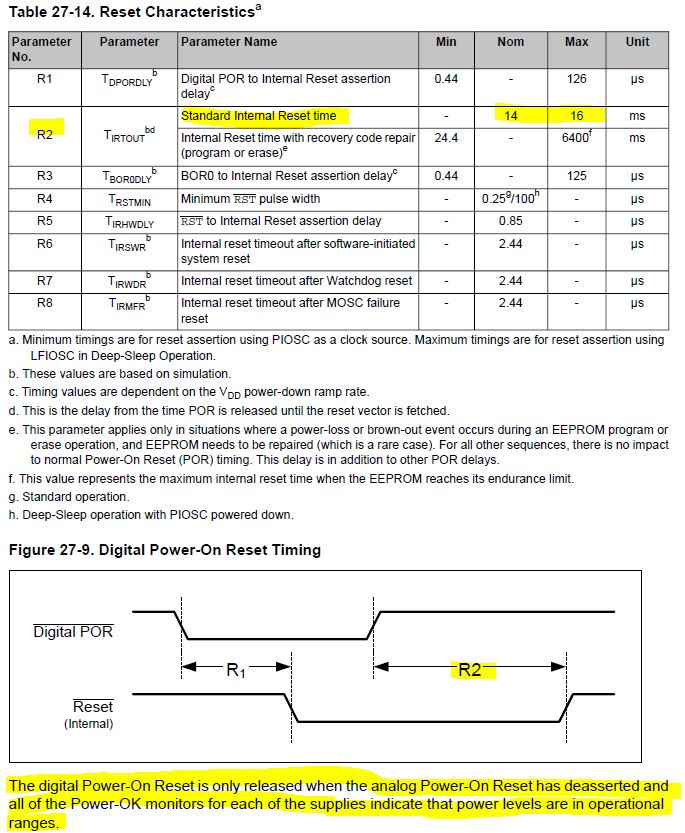

Is there any specification of the timing from power-on to deasserting RST(external reset) pin?

What is specified in the datasheet is the de-assertion of digital POR to the deassertion of internal Reset. Please refer to the datasheet for details.
The Digital POR is is only released when the POR has deasserted and all of the Power-OK monitors for each of the supplies indicate that power levels are in operational ranges.
