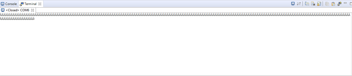

here how the output looks like

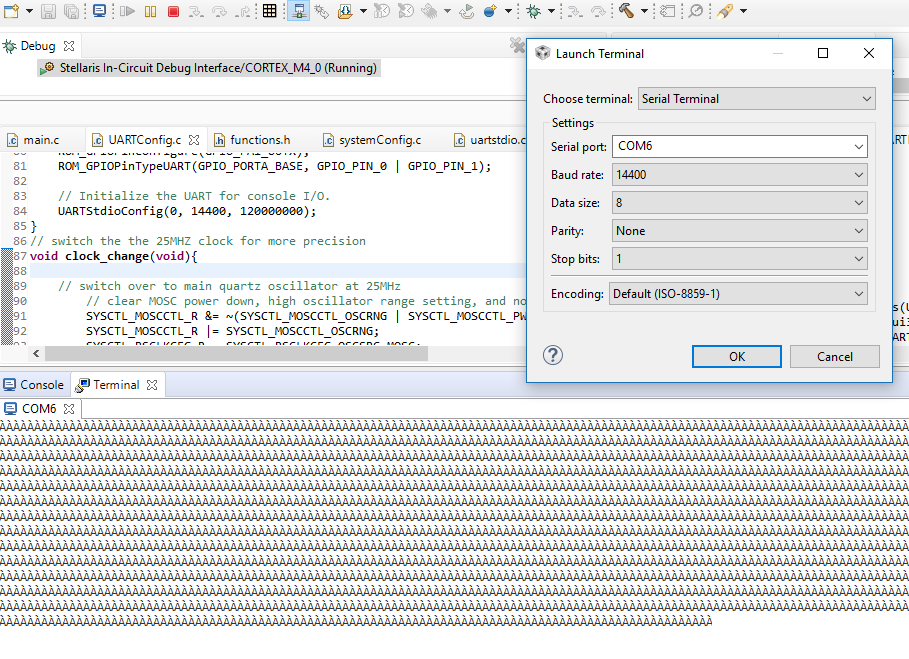

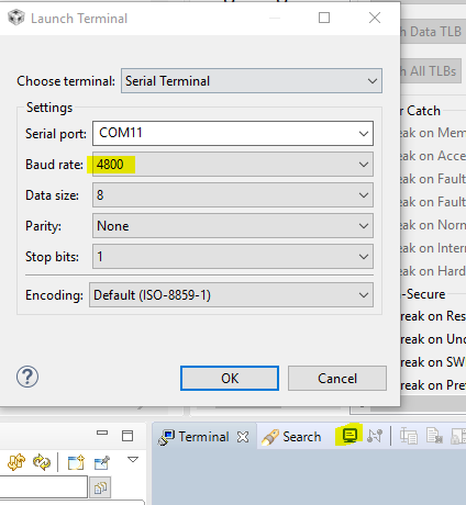

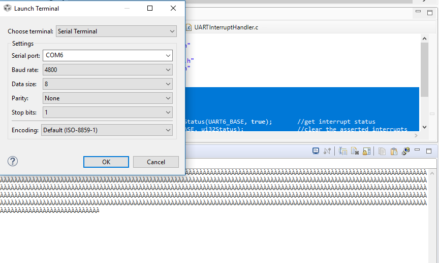

    thank for your reply, but i dont think this is the problem. iam sure i have the right baud rate at the terminal, see here please
    i also change it to 14400 and 9600 and still the same, just differs in the speed of the readings and the printing
  • Then are your really running at 120MHz? I see a function "clock_change()" in your last post. The third parameter in UARTStdioConfig() needs to be the current system clock frequency in Hz so that it can properly set the baudrate you requested. If the system clock is only 25MHz, then it should look like this:
