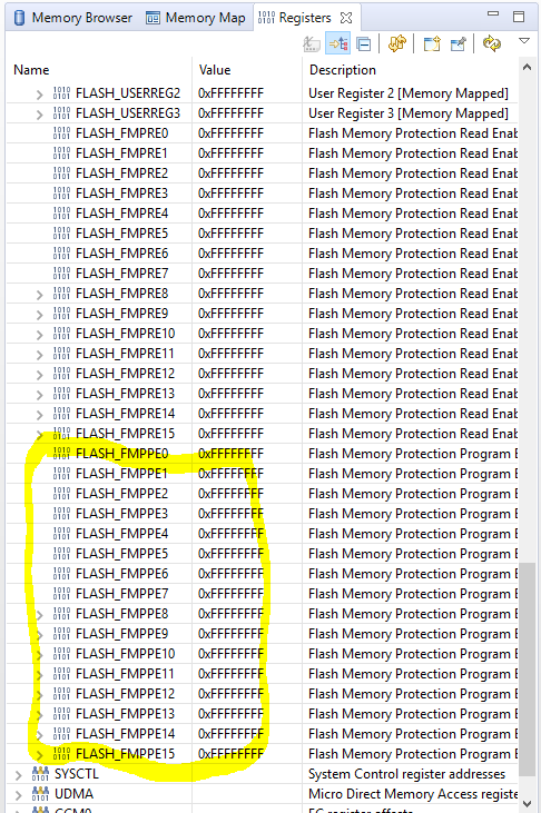

  • Use the Code Composer Register window and check that the "FLASH_CTL" -> "FLASH_FMPPEn" registers are all 0xFFFFFFFF.
