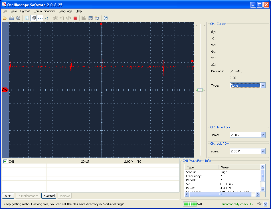

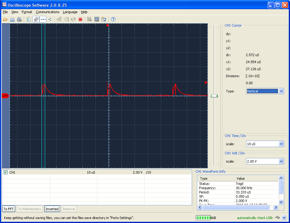

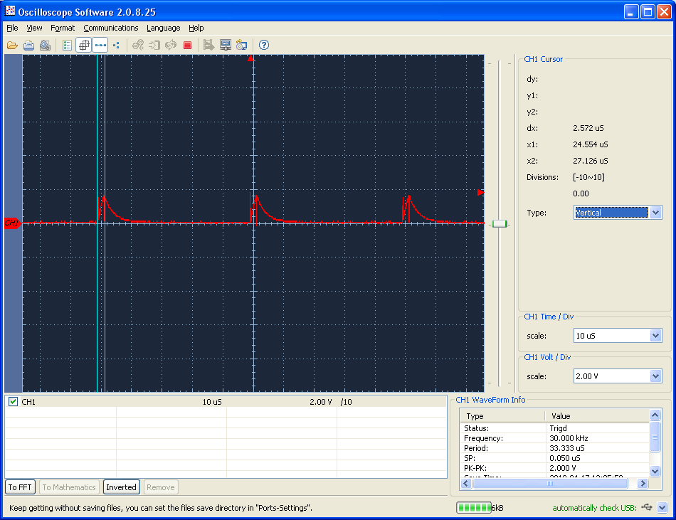

Relative to same issue of edge counts unidentified internal noise source; Scenario GPTM0A CCP0 configured 20Khz PWM and GPTM0B CCP1 input edge counts, wire PL4 into PL5 with WPU oddly drags down 4mA PL4 near 2v. Adding Schottky in series PL4 to PL5 produces whisker like 20Khz pulses riding on 3v. Otherwise PL4 (CCP1) counts 49-200Hz edges from external open collector Taco source without issues until other GPTM are later being enabled, GPTM1A and GPTM4A each configured as Oneshot timers, 1A with interrupt vector and 4A as an ADC trigger source to ADC0 SS2. Both GPTM0A/B use alternate PIOSC clock source and have no match events configured lower than 0xD3.
How could PL5 CCP0 input to PL4 WPU pull down the signal? DMM check PL5 has typical 1.7v drop and 6 Megohms to ground. Why would the open collector on PL5 not pull down the signal even though is much slower rate than PL4 20Khz? It seems like PL5 is acting like an bidirectional GPIO port when PL4 PWM signal is input to it.
20Khz CCP0 PWM PL4

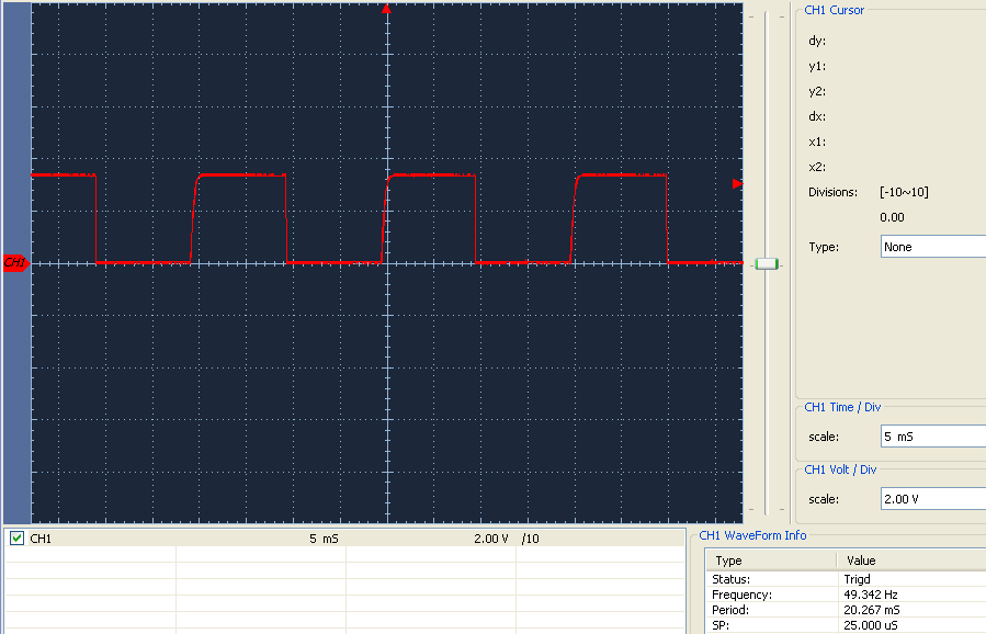

Open collector Taco source PL5 WPU:
PL4 input to PL5 WPU without open collector signal above:

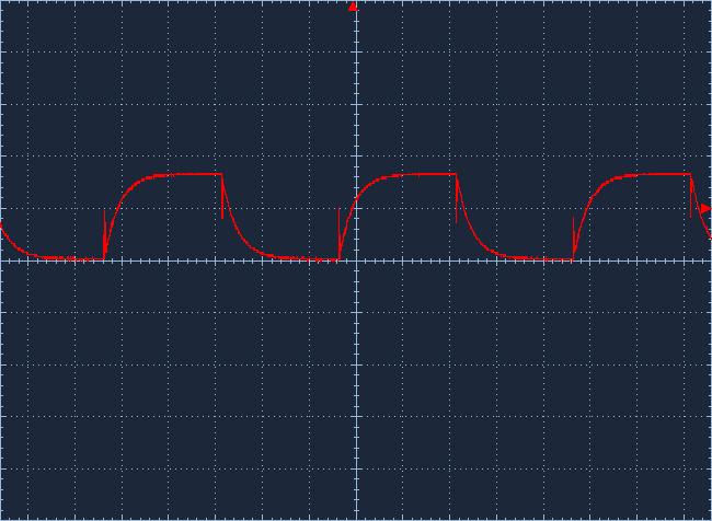

  • Otherwise setting the PWM duty cycle to 50% also reduced loading of PL5 20KHz signal into PL4 input, even with 22nf remaining in the circuit.
  • BP101 said:
    There should have been roughly 400mV drop from 100 ohms which limits high 2.9v PWM signal to 29mA. It seems there is not 4mA being delivered on PL4 even as PAD was set to 4mA
    BP101,
    I don't understand this statement. If you are trying to drive a 100 Ohm resistor in series with a 22nF capacitor, the initial current would be 3.3V/100 Ohms or 33mA. That way exceeds the 4mA minimum drive current. You should expect to see an voltage curve increase as the 22nF capacitor charges. Perhaps a simple circuit diagram would help me understand what you are trying to say. The scope picture you provided does not have a voltage or time scale so it did not help.
    I always use I=E/R to limit the pin current to not exceed the resistors ohmic value, using Ohms law sets maximum current, not the minimum. Oddly the external open collector drive into PL5 input had no issue with 22n cap but driving PL5 from PL4 set to 4mA fails. This seems to prove PL4 being set 4mA drive strength is not producing 4mA. Again PL5 being limited to 29mA (100Ohm) of a GPIO pin out high level, not 3v3 DC supply. The maximum drop across 100ohm at 4mA drive strength and 2.9V logic high gets 400mV. Yet the 3rd scope capture shows nearly 1.2v drop, thus proves PL4 is not outputting 4mA even in the excessive 20Khz roll off.
    The external open collector drive (5mA) into PL4 is now in series with 5.6K and triggering edge counts via the same 22n to ground. Have also replaced PL4 100ohm with 5.6K into 10K impedance (PWM) to control external noise from entering the GPIO pins. Oddly testing ferrites on the open collector PL4 produced voltage spikes above/below both MCU rails. Something is not right with that as ferrites (140mOhm / 1Kz@10Mhz) are supposed to reduce signal ringing not cause it.
    Function: Frequency generator and PWM:
    /cfs-file/__key/communityserver-discussions-components-files/908/Fans-Orian-24v-circuit_5F00_diagrams.pdf

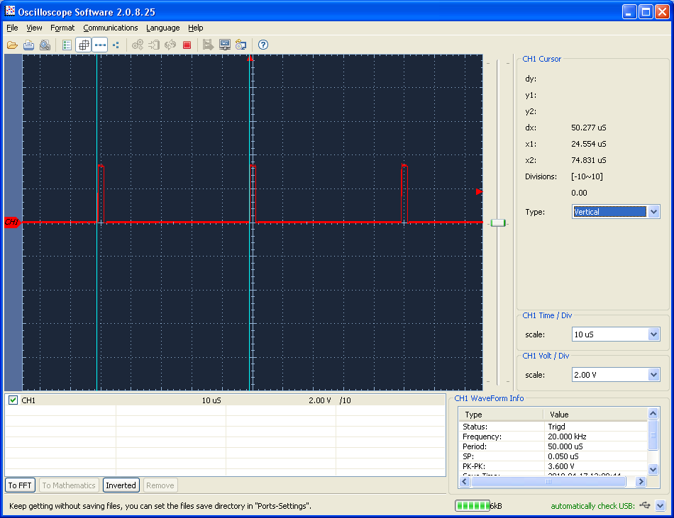

  • This test to me indicates the CCP pin design can not produced our GPIO set drive strength (4mA) at certain duty and or frequency. The change in duty cycle from 1% to 50% @20Khz, last scope capture proves an drive strength errata for CCP pins.
    The second part of proof being PL5 PWM 1% duty 4mA drive strength (100Ω or 5.6K) into 10k external impedance does not load PL5,e.g 2nd capture 1st post.

    I disagree. I think you are not taking into account the current that is needed to charge the 22nF capacitor and the time it will take for the voltage to rise. I have requested a diagram or schematic of what you have connected to PL4 and PL5 so that I might help you.

  • BP101,
    I asked for the schematic because I did not suspect that you are missing the obvious. It is the capacitor that is loading PL4, not that PL4 cannot provide the 4mA current and not that PL5 is loading the circuit. You have to treat a PWM as an AC circuit, not a DC circuit. Let's take the extreme example and treat PL4 as a constant current source of 4mA. The voltage on the capacitor is V = I * t / C (voltage = current x time / capacitance). Use a capacitance of 22nF, and a current of 4mA. A 1% duty cycle pulse of a 20KHz signal is 500nS. 4mA * 500nS / 22nF = 0.09V. The truth is that starting out PL4 is delivering more than 4mA, but it cannot deliver the 90mA that would be required for the voltage to reach Vih of PL5 before the PWM circuit switches PL4 low again and it starts draining the capacitor. Remove the capacitor from your circuit and then check the resulting PWM to verify that what I am saying is correct.
    Yet the Orion PDF shows 5mA Max from Open collector frequency output and PL4 WPU and edge counts CCP1 is not being effected by 22n at 1% duty. I find your 1% duty math not to convincing in this scenario and lean more toward 2mA PAD strength is being produced even when 4mA has been set. The fan frequency output can not deliver 90mA drive strength to PL4 and 22n is not a problem @1% duty, only PL5.

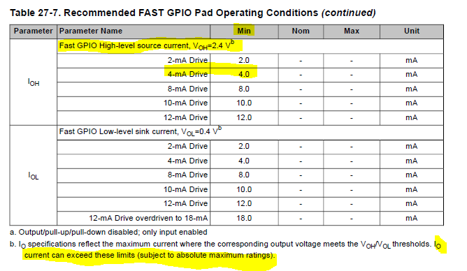

  • I give you an exercise so that you may answer your own questions. Frist, what does TI mean by a 4mA output. We find the answer in table 27-7 of the datasheet. The output pin, in 4mA mode, can drive at least 4.0mA to a voltage of 2.4V.
    In other words, the pin should be able to drive a 600 Ohm resistor to 2.4V. Try it for yourself. You can use a standard 560 Ohm or 680 Ohm resistor if you don't have a 600 Ohm resistor handy. Drive it with the pin and measure the voltage. From that you can calculate the current that the pin is providing.

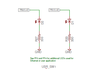

    To answer the LED question, here is a snippet from the EK-TM4C1294XL schematic showing that the LEDs are in series with a 330 Ohm resistor.
    By measuring the voltage at the positive end of the resistor, you can determine the current through the resistor. It is the same current through the LED. Also measure the voltage at the anode of the LED (same as measuring the voltage at the TM4C pin). Now compare these measurements with the pin configured for 2mA and then for 4mA. Finally, look at the LED datasheet for the luminosity at those currents. The LEDs are Everlight  19-217/G7C-AL1M2B/3T.
