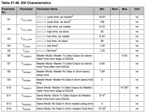

TM4C1294NCPDT: SSI timing specification for SPH=0
Part Number: TM4C1294NCPDT
I have qestions about SSI timing for TM4C1294NCPDT.
I would like to use SSI with SPH = 0. However, the timing chart for SPH = 0 is not described in the data sheet, and the following table seems like the timing specification for SPH = 1.
Q1: If SPH = 0, how should I handle the timing rules of S6? Does it mean that Tx data is output as soon as SSIFss becomes active?
Q2: Is the timing specification of S7 to S14 difference between SPH = 0 and SPH = 1?
