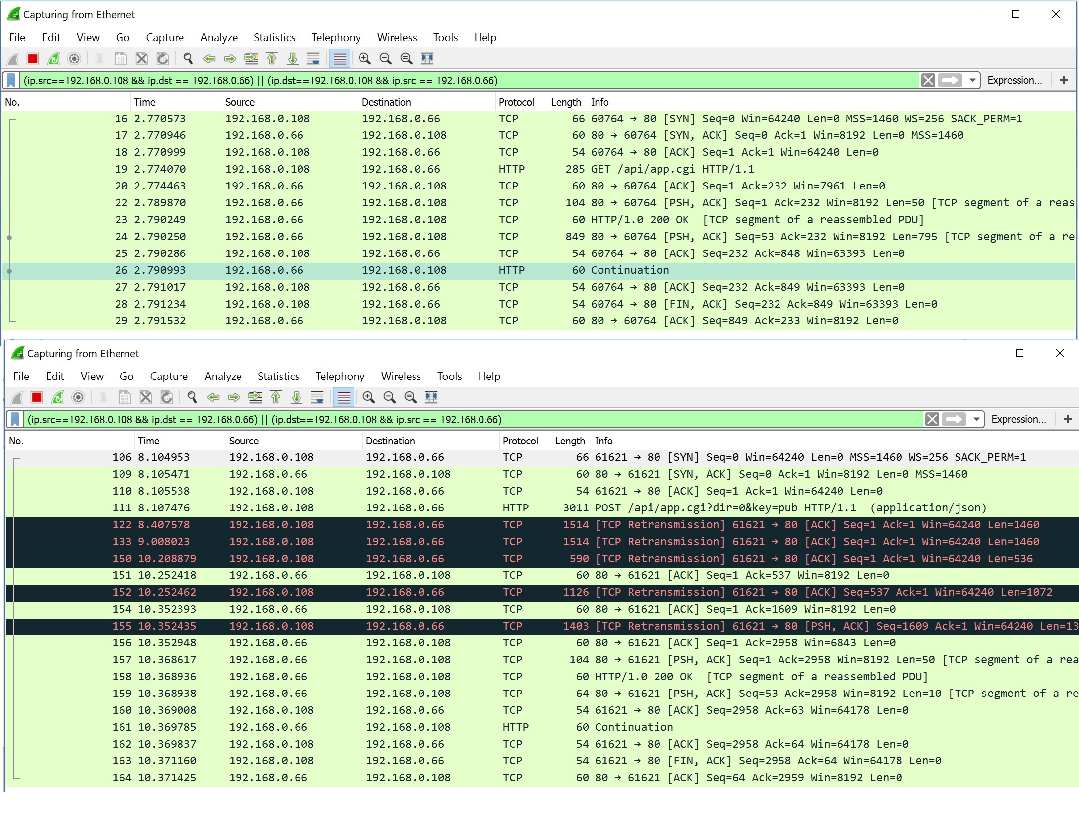

  • I have increased the LOW,MID,HIGH task sizes from 1024 to 4096, now it can accept large POST payloads, however the processing time increased. When the payload size is around 1280... the HTTP Server response time is about 50ms, above that value it takes around 2500ms...
    Are you able to get Wireshark capture in the case where the payload size causes the response time to be around 2500ms?
    If you haven't applied the fix for TIDRIVERS-368 as linked on Networking on TM4C129 Devices, then if the large POST request initially causes the maximum size packet is sent to the Tiva device, a possible effect of the TIDRIVERS-368 bug is that the maximum size packet may be dropped causing the sender to retry with smaller packets after a delay.
    I have attached 2 captures from a smaller and a larger request. I have read the thread in that you linked but I am still not sure what to do in order to resolve this problem.
    The 2nd capture for the larger request shows two packets with the maximum length of 1514 apparently not being received by the TivaC device (assumed to be IP address 192.168.0.66) before the post completes with smaller size packets. This results in an overall post duration of around 2300ms. This is a sign you are being affected by bug TIDRIVERS-368.
