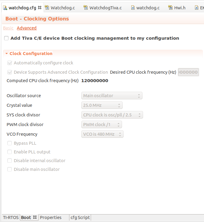

I configured wdt in ti-rtos platform.
My system will work on 120Mhz so based on this wdt will period will set to 120000000 for getting 1sec delay. But it will hit interrupt handler in 2sec.
While set the period to 60000000 it will hit the interrupt handler time of 1sec.
What is the cause of this?..

    But while i check the configuration file clock frequency shown to be
    watchdog.cfg -> BIOS -> Properties ->spuFreq : 120000000
    Like this...

  • Ralph Jacobi said:
    Typically for TM4C129 the output of SysCtlClockFreqSet would be used to verify the clock frequency, but I am not sure how that works in TI-RTOS to check the clock is running at the right frequency, though I imagine that is when set via the BIOS.
    In the watchdog_EK_TM4C1294XL_TI.zip project which was attached by Nikhil the "Boot - Clocking Options" has the CPU clock frequency configured at 120 MHz:
    In the Debug/configPkg/package/cfg/watchdog_pem4f.c file which is generated by SYS/BIOS contains the following which sets the CPU clock frequency to 120 MHz during startup:
     *  ======== ti_catalog_arm_cortexm4_tiva_ce_Boot_init ========
    xdc_Void ti_catalog_arm_cortexm4_tiva_ce_Boot_init()
        ti_catalog_arm_cortexm4_tiva_ce_Boot_sysCtlClockFreqSet((xdc_ULong)
            (-251656576), (xdc_ULong)(120000000));
    I stepped in the debugger and the ti_catalog_arm_cortexm4_tiva_ce_Boot_sysCtlClockFreqSet call did return 120000000 (albeit the value is not saved in any variable).
