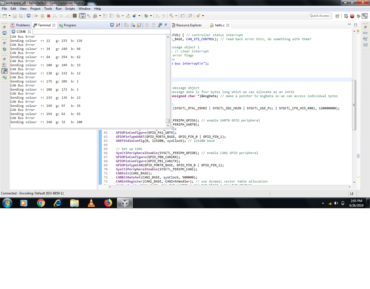

TM4C1294NCPDT CAN BUS Error
I am new to CAN interface programming. I tried to establish CAN communication between 2 TIVAC boards using MCP2551 transceiver. I got some help from ohmninja website for basic CAN programming. my basic idea is to read sensor value through ADC in one TIVAC and send the same to other TIVAC through CAN interface. The transmit and receive programs gets compiled successfully and I can able to build the project. But once I check the UART for output I end up with CAN BUS error. I post my program and output screenshot plz do help

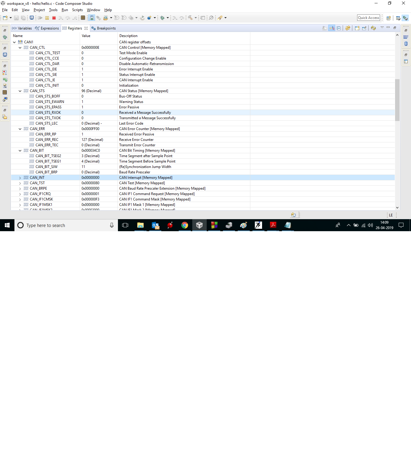

Error generated in Transmitter side
transmit registers
receive error
  • It looks like the receive code you wrote started as an example for a TM4C123 device that you modified for the TM4C1294. The CAN baudrate is not set correctly because the original code uses the function SysCtlClockGet() within the call to CANBitRateSet(). That function is not supported on the TM4C129 devices. You can replace that function call with a constant value, 120000000 if you do not change the frequency.
