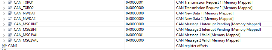

i am working on two tm4c123gh6pm boards..My aim is to send data from one board to other using CAN protocol.
I have used Transceivers(MCP2551) and 120ohm terminations at both ends of the boards.
The Tx pin (PB5) of the Transmitter board is always high .There is no data coming out of the transmitter pin.
The Rx pin is at  Low.
The registers are configured as follows after the code is build and debugged.
I have tired interpreting these registers and found that there is no bus-off state ,the interuppt counter is less than 256 which i think is fine.
Any help will be welcomed.
Thanks in advance.
Is the delay of 1 second used in the code is correct ?
The following is the code i have used at the Transmitter side.....
