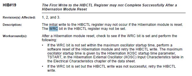

     Please take a look at the below two errata and see if you are hitting what is described. Apply the workaround and see if they make any differences. I will suggest you to go through the device errata document.

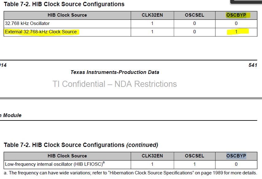

  • Dear Charless,
    Thanks for your feedback.
    In our understanding, the HIBERNATE_OSC_HIGHDRIVE is set when 24pf Capacitor is used while connecting external 32.768Khz Crystal. Setting this HIBERNATE_OSC_HIGHDRIVE bit, should not bypass the internal 32kHz oscillator. Internal 32.768KHz oscillator should be bypassed (OSCBYP=1) only when single-ended oscillator is attached to XOSC0 pin. In our design, we use external 32.678 KHz Crystal with 24pf load capacitor (not Single ended external Oscillator). So, in the software, HIBERNATE_OSC_HIGHDRIVE is set, HIBERNATE_OSC_DISABLE should not be set (OSCBYP=0). Hence we have not set OSCBYP to 1 in the software. But this bit OSCBYP is set to 1 automatically. We don't know the cause for this automatic changing of this BIT to 1.
    Could you please suggest for the possible causes.

  • Hi Ettickkan,
      I think you might be confused with the LFIOSC (low frequency internal OSC). When OSCBYP is 1 it is to bypass the internal LFIOSC, not the oscillator that works with the external crystal.
    As I also showed in my reply, now pasting again below, if you look at how the driverlib is implementing the HibernateClockConfig(HIBERNATE_OSC_HIGHDRIVE) the OSCBYP will be set to 1.

  • Hi Ettickkan,
    I have not heard back from you. I hope it is clear to about the OSCBYP setting. I will close the thread for now. If you have new question you can open a new thread or if you have some updates to share you can just reply back to this post.
  • Dear Charles
    Thanks for your reply and sorry for my late response.
    Your explanation is clear and understood that OSCBYP is set to 1 to bypass the internal LFIOSC and also the explanation in Table 7.2
    But my question is in the second part of your answer.
    When we call the driverlib using the function HibernateClockConfig(HIBERNATE_OSC_HIGHDRIVE) OSCBYP will be not be set to 1. Only OSCDRV bit will be sent to 1 as we pass the parmeter to that function.

  • Hi Ettickkan,
    Sorry, I missed your reply. I re-evaluated the code again and you are correct that the OSCBYP should not be set if you only call HibernateClockConfig(HIBERNATE_OSC_HIGHDRIVE). You are using an external crystal and the internal oscillator should NOT be bypassed. I'm very sorry for the confusion.
    Did you have a chance to evaluate if your problem is due to the errata HIB#19?

  • Hi Ettickkan,
      I cannot understand why the OSCBYP is set by itself unless it is written by the software. Have you tried the HIB#19 workaround and prove that it is not working?
  • Hi Charless
    As mentioned already, since it is a repeat failure once the problem occurs, we did not try the solution suggested in HIB#19?
    Also it is very difficult to simulate the occurrence condition as it is rare and random.
    Do you feel, that it would be better to implement.  Please suggest.

  • Hi Ettickkan,
    Can you answer a few questions?
     1. The problem is intermittent, random, correct?
     2. How long does it take to see the problem after each power cycle?
     3. How long are these 4 units on the field before they are returned?
      4. Is it possible for you to swap one of the 4 returned units into other good boards you have. Can you still reproduce the same issue? This is to make sure it is not a board related problem.
    Yes, I strongly recommend that you implement the HIB19 workaround and prove that it either works or not works. If the workaround does not work, then it is possible a hardware problem (i.e. damaged MCU)

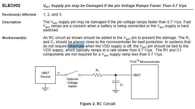

  • Hi Ettickkan,
      Thank you for clarifying the questions I have. I understand you wanted to know the reason why the OSCBYP is set unintentionally, I just don't have a good answer as to why the OSCBYP bit is set by itself.  Do you see any other register bits in the Hibernation module not retaining their states when the OSCBPY is set? What I can think of is that the OSCBYP is a register bit residing in the Hibernation module which is powered by the Vbat. I can image a register bit to flip its state when its operating condition is out of spec.
    Do you think you have a stable Vbat supply?
    Do you have the recommended RC filter on the Vbat?
    Any possible noise on the supply?
    Earlier I also mentioned about errata ELEC#2. Can you please also check if your VDD ramp up time is faster 0.7V/us?
    The reason why I'm trying to connect dots between OSCBYP and the Vbat is because you mentioned that the MCU is acting normal until the problem occurred. After the problem occurred, you can get it back to normal by first removing the battery and then connect back the battery.
    Can you use the scope to monitor the Vbat and compare between the board that is normal against the board that starts to have OSCBYP set?
