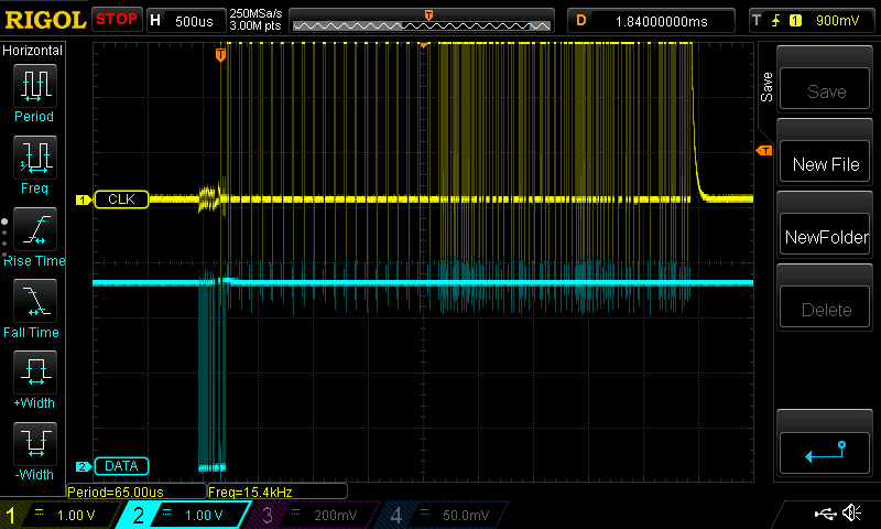

I am working with Tiva C series TM4C123GXL and PGA460 ultrasound sensor, firstly I am just trying to receive some initial messages in order to continue. However, I have encountered an issue that longer messages do not come in full. I tried with FIFO of different sizes and without it, all come to same issue that the message received is incomplete, although looking at oscilloscope, the message does arrive in full (see image bellow). Without FIFO I get 6 bytes of data plus one byte that should not appear when interrupt happens. The very first byte in the RX that is stored is not related to the received message as all messages start with 0x40 but first byte "received" is always 0x00 and second one is 0x40, so I am not sure how to fix this issue either. With FIFO I am not getting whole message either, the amount depends on size for FIFO. I am trying to receive in this case 45 bytes (in general message is not constant size but this one is one of the largest). The code I am using is bellow (adapted from uart_echo.c example, which works).  Interrupt is set up in the startup file accordingly.

      In your scope, what is the yellow and what is the cyan? It says clock and data. The UART is asynchronous. It has not have clock. Unless you meant the clock for RX and data for TX.

    Thank you for your response. I didn't think that the picture may mislead here. In the oscilloscope, the names are default ones, they have nothing to do with CLK or DATA. The blue line is the transmission from TIVa to the sensor, yellow one is the response. It is supposed to receive 45 bytes and stops after 6 bytes read and continues to poppulate the array with exact same values, that is my question why it does that. I have managed to fix that issue as it was the delay I kept from the example which I removed from the interrupt handler and it fixed that issue - it reads whole message. However it still adds a zero to first position of the array and only after that the response from the message. That is the only issue left to resolve. I do know that with other MCUs I have usued I didn't have this 0x00 byte added when interrupt is triggered and it is not part of the message, it just seems that the Tiva adds it by itself.
