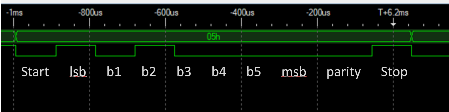

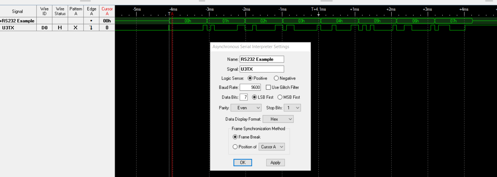

Using UART3 as RS485, I can communicate at 9600, 8, 1, None.  When I change the comport settings to 7, 1, and Even, the data is not correct.  Here is my init code:
