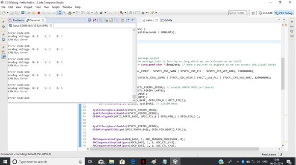

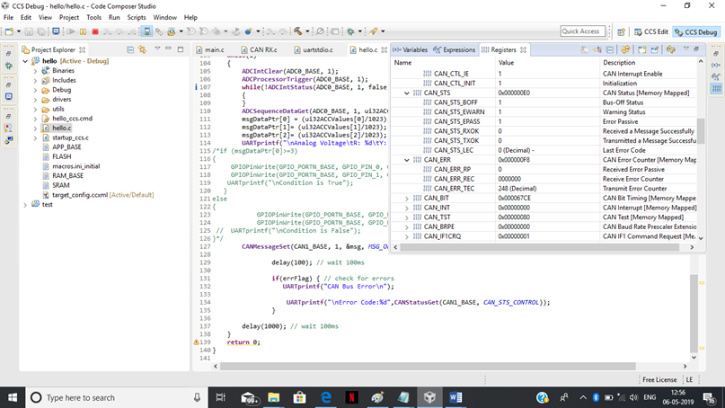

I am getting error code as 224 and shows CAN bus error even I tried to figure out through CRO but iam not getting any signal from CAN TX/RX pins PB0 and PB1

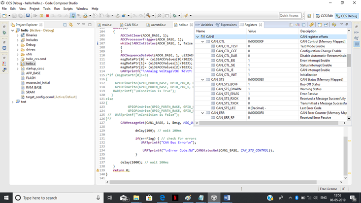

Here the CAN STS TXOK is still zero I dobubt whether my CAN controller is working or not
Here the CAN ERR TEC register shows 224 as code what does it mean clarify

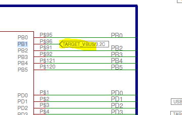

    SysCtlPeripheralEnable(SYSCTL_PERIPH_GPIOB); // enable CAN1 GPIO peripheral
    GPIOPinConfigure(GPIO_PB0_CAN1RX);
    GPIOPinConfigure(GPIO_PB1_CAN1TX);
    GPIOPinTypeCAN(GPIO_PORTB_BASE, GPIO_PIN_0 | GPIO_PIN_1);

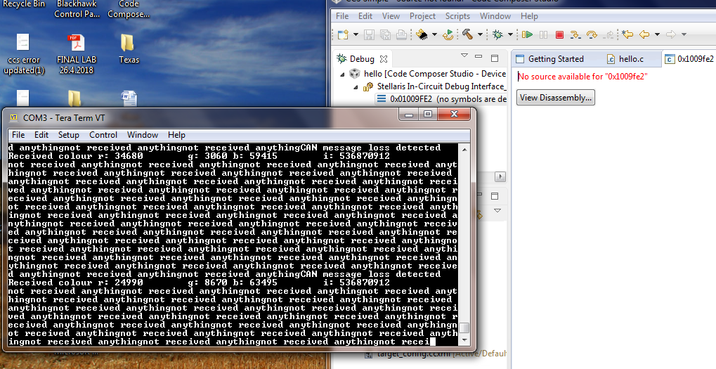

iam not getting any information in receiver side the rxflag not getting any interrupt from transmitter side

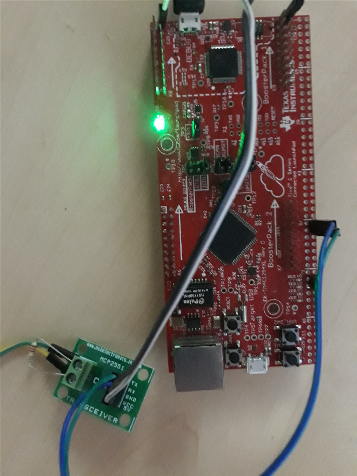

  • The status bits show that the CAN transmitter is bus off. I suspect this is because you have not connected the CAN bus properly and the bus is permanently in the dominate state or when the transmitter tries to output a dominate (CANTX low), it reads a recessive (CANRX high). You cannot just connect CANTX from one device to CANRX on another. You must have a proper CAN bus with transceivers and termination resistors. Here is some information about how to create a CAN bus:
    www.ti.com/.../sloa101b.pdf

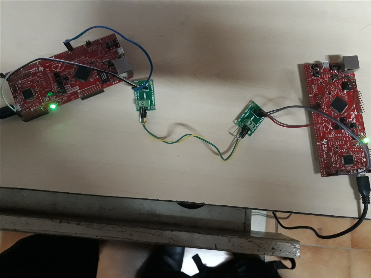

  • Dear Crosby,
                        Thanks for your suggestion. I am using MCP2551 transceivers for communicating between two TIVAC (TM4C1294NCPDT). I can able to transmit the data from transmitter. but i did n't get anything from receiver

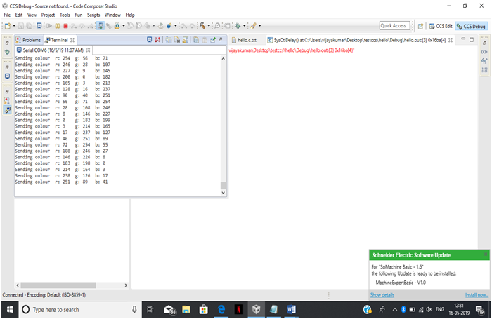

    Transmitter signal

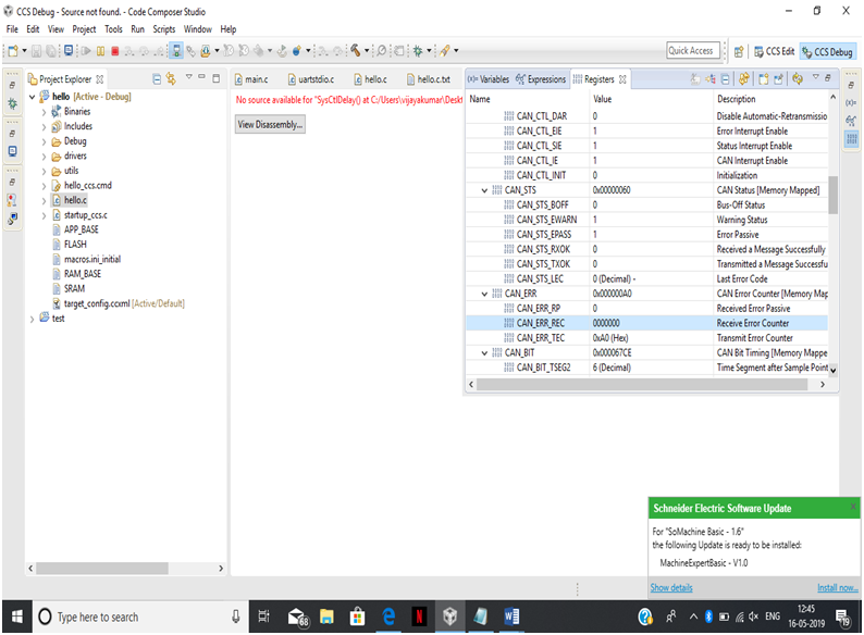

    The transmitter register window shown below

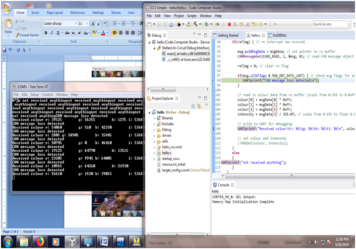

    During receiving CAN message loss was detected. I do step over to check whether i can able to receive any thing but it is not properly receiving the transmitted signal
    received signal
    When i press resume button i got the following output

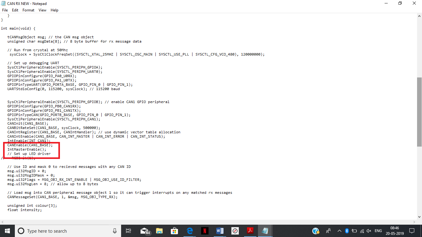

    I guess the problem may be in the receiver code or in the connection plz do help me
     * CAN bus LED controller slave firmware
     * Written for TI Tiva TM4C1294NCPDT
    #include <stdint.h>
    #include <stdbool.h>
    #include "inc/hw_memmap.h"
    #include "inc/hw_types.h"
    #include "inc/hw_can.h"
    #include "inc/hw_ints.h"
    #include "driverlib/can.h"
    #include "driverlib/interrupt.h"
    #include "driverlib/sysctl.h"
    #include "driverlib/gpio.h"
    #include "driverlib/uart.h"
    #include "driverlib/pin_map.h"
    #include "utils/uartstdio.h"
    //#include "drivers/rgb.h"
    volatile bool rxFlag = 0; // msg recieved flag
    volatile bool errFlag = 0; // error flag
    unsigned int sysClock; // clockspeed in hz
    // CAN interrupt handler
    void CANIntHandler(void) {
       unsigned long status = CANIntStatus(CAN1_BASE, CAN_INT_STS_CAUSE); // read interrupt status
       if(status == CAN_INT_INTID_STATUS) { // controller status interrupt
          status = CANStatusGet(CAN1_BASE, CAN_STS_CONTROL);
          errFlag = 1;
       } else if(status == 1) { // msg object 1
          CANIntClear(CAN1_BASE, 1); // clear interrupt
          rxFlag = 1; // set rx flag
          errFlag = 0; // clear any error flags
       } else { // should never happen
          UARTprintf("Unexpected CAN bus interrupt\n");
    int main(void) {
       tCANMsgObject msg; // the CAN msg object
       unsigned char msgData[8]; // 8 byte buffer for rx message data
       // Run from crystal at 50Mhz
        sysClock = SysCtlClockFreqSet((SYSCTL_XTAL_25MHZ | SYSCTL_OSC_MAIN | SYSCTL_USE_PLL | SYSCTL_CFG_VCO_480), 120000000);
       // Set up debugging UART
    UARTprintf() rolls crazy inside while loop can cause application crash issues if buffer floods.

  • hi bob,
                 I  added the IntMasterEnable() fuction in the receiver code like below
    but still iam not able to get the output. I wonder why message loss has occurred in receiver side. whether it is due to hardware or software clarify me plz

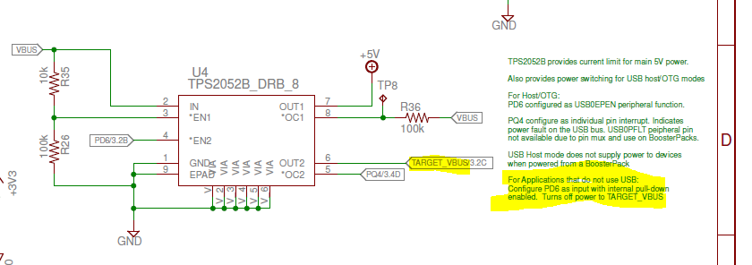

  • Did you check the voltage on the PB1 pins? Remember that on the EK-TM4C1294XL that pin is used as the USB OTG VBUS signal and is attached to 5V. The schematic is here:
    http://www.ti.com/lit/ug/spmu365c/spmu365c.pdf#page=31
  • Hi bob,
               finally I got the output as you told I added the IntMasterEnable(); function in the transmitter code instead of receiver code. As well as BP101 gave me some suggestion regarding the if loop condition in the receiver code. When I added both of your suggestion I got the output immediately. Thanks both of you for your guidance.
    Perhaps Bob can explain why the IntMasterEnable() is even required when the CAN peripheral interrupt was being enabled. I had thought Master performed a NVIC global function when ALL interrupts need be enabled or disabled at the same time. Past had tried to use Master to bulk control enabled peripheral INTS in a function and two Master disabled INTS kept pending until they were disabled at the peripheral level too. Seems a bit misplaced to have both Master & peripheral INT controls to immediately stop the peripheral from pending when Master alone should stop pends.
  • The architecture has three levels of enable for the interrupts, the peripheral (ex: CANIntEnable(…);), the vectored interrupt module, VIM, (ex: IntEnable(INT_CAN1);) and the CPU (ex: IntMasterEnable(); )
