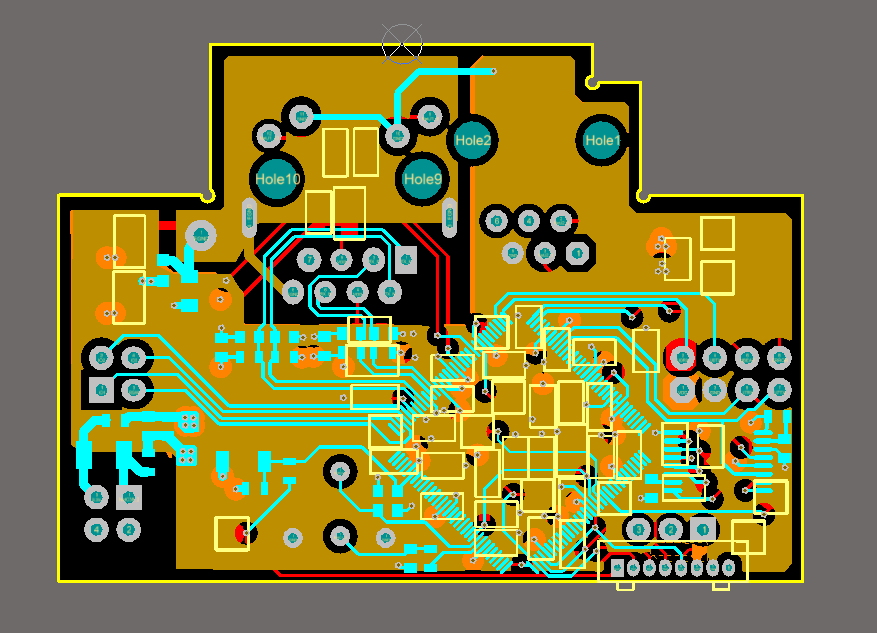

The following image shows the layout.
Can the Rx and Tx line be swapped for reducing the length of tracks as it supports auto-mdix?

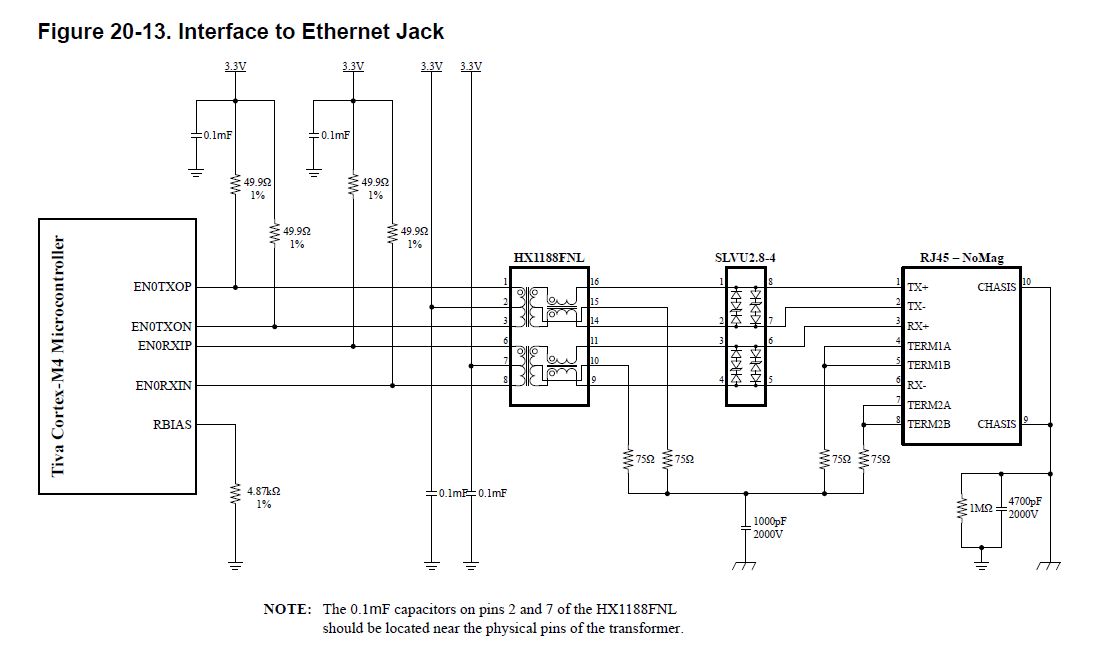

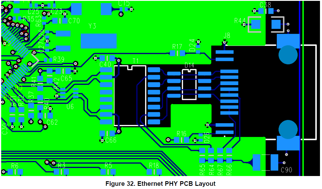

  • I may be having trouble interpreting the schematic from your layout, but that does not look like the recommended circuit from the datasheet or the recommended layout from the design guideline.

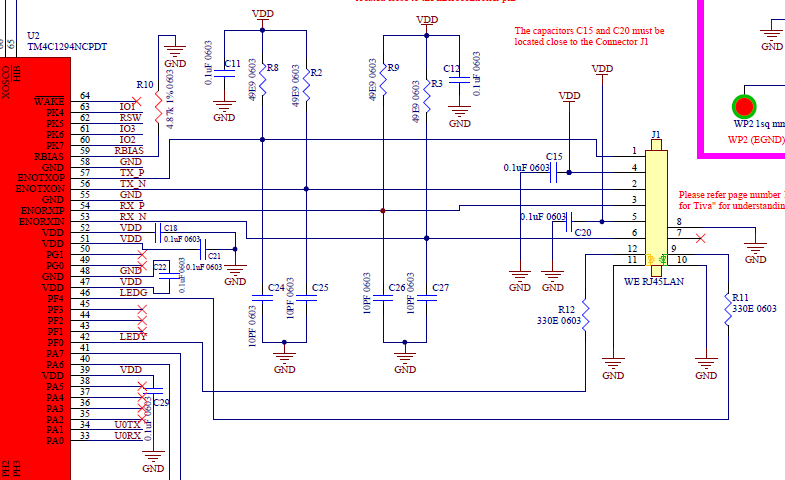

    This is the schematic of the above layout. We are using a connector with inbuilt magnetics therefore the layout doesnt look the same. But the differential line are routed parallel in the layout with keeping the track parameters as suggested in the guidelines.

  • Changing the parts list and the layout does affect the radiated emissions. Meeting your radiated emissions test limits with your design is beyond the scope of what I can do for you on this forum. If you don't have the necessary EMI experts in-house, you may want to consider hiring an expert consultant.
    Switching the TX and RX pairs is purely an application decision and should not be a problem if always connecting to an Auto MDIX switch. While that can shorten the routing under the RJ45 connector, I don't know if that will solve your emission problem. Moving the RJ45 connector on the other side of the board would have a similar impact.
