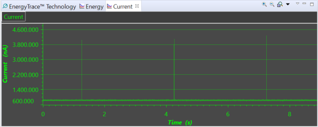

I have recently bought a tmdsemu110-u + HDR for ET power measurements of the CC1352. Everything seems to work fine apart from the minimum current that i can measure. When i know that with 3.3v supplied the current i should measure is 2-3uA, I get 500-600uA from ET. This is with the low setting, using CCSv8 or 9, with or without the HDR.
Is there some diagnostics or some updated FW that I need to use with the Probe in order to fix this issue ? or is it bust ?

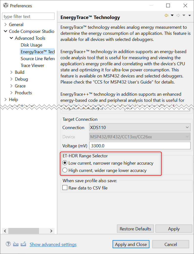

    There are no diagnostics per se that can be performed, but I just recalled something that may be misconfigured in your environment.
    Did you set your the EnergyTrace Range Selector to low current? That may make a different in the lower end of its range.

  • H Rafael, yes I have this set. I have followed all the procedures.

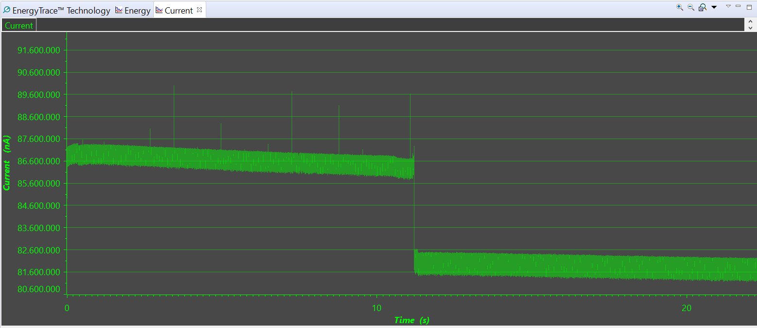

    Yesterday I did a series of tests with the pinShutdown project and found a very high power consumption that I am currently blaming on the project itself. However, I did not experience such persistence in erroneous readings.
    For example, I read between 81mA and 87mA depending on the "shutdown" status of the processor - that using a TMDSEMU110-U + a TMDSEMU110-ETH on ET mode and no JTAG connection (nor jumpers connected on the target). These measurements were confirmed with a DMM.
    What do you read if you simply disconnect one of the wires to the target? Do you get near zero Amps? That is what I get when using the Low current mode:
    In high current mode I get a perfect zero Amps (due to the lower resolution applied).
    If you still see the 600µA under these conditions, something seems indeed out of order.

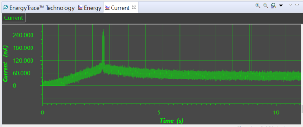

    1) I reflashed the XDS110 probes with the latest firmware.bin from CCS9, and after downloading the program to the board, removing the JTAG connector - then with the XDS110 alone I get reasonable results - measuring mean current values down to 2uA etc. So no longer the 600uA problem.
    2) However the HDR module is problematic. It doesn't seem to add anything to the resolution of the measurements as it stops working after 4-6secs. Both HDR modules that I have seem to have the same issue. It stops logging with data stream error or energy trace current exceeded. This is on the same current measurement that the XDS110 alone was working fine on. In addition the start-up current is high. I have screen shot the good and bad situ's for your view - will upload. Do you know what this could be ? Is it possible to update the FW on the HDR ?

    In the past week I have been trying to investigate what could be happening in your environment and found out a few details:
    The HDR present on the LAUNCHXL-CC1352R seems to be very noisy. I did not use it after seeing a swing of several hundreds of µA.
    I modified the simple peripheral example as you mentioned. I still get spikes but a good baseline.

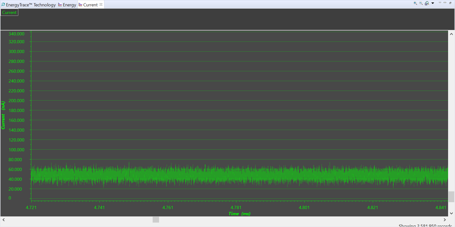

    I think I found the root cause for the 600µA you are reading.
    Accidentally I left the XDS110 base JTAG connector plugged to my board while performing EnergyTrace but outside of a debug session. I then read the same value:
    Unplugging the JTAG connector I removed the excessive leakage through its pins (I suspect a loop between GND and Vsense was the culprit).
    Rafael

  • Hi Rafael,
    For the 600uA issue I see the same. The JTAG connector only needs to be connected with no Debug session initiated to record 650uA.
    Then with JTAG connector removed: 50-60uA.
    Then with the RXD header in place: 2uA.
    Seems that some new documentation is in order !
