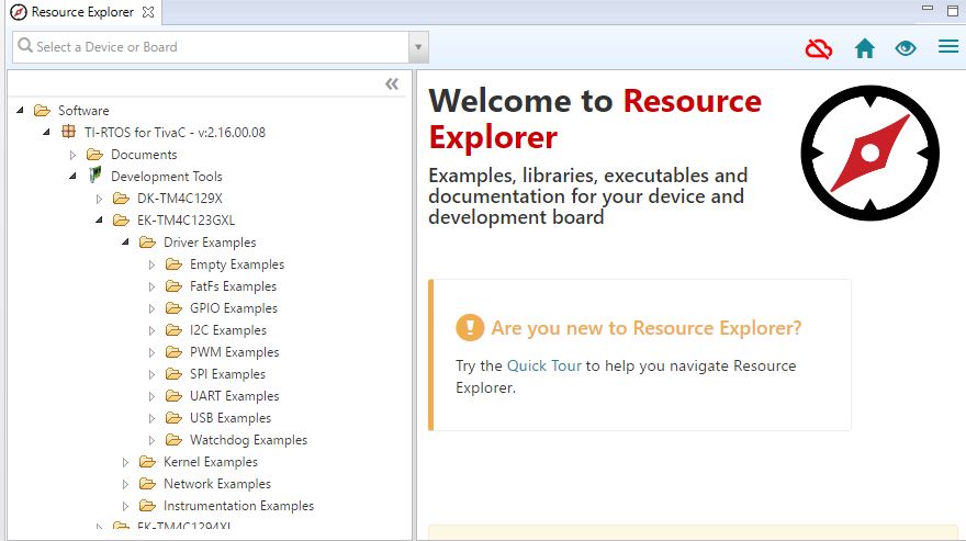

Hi Ugra,
Please download TivaWare if you have not done so. Please go to this link to download the TivaWare.
Once the TivaWare is downloaded you can go to <TivaWare_Installation>/examples/boards/ek-tm4c123gxl and find many examples. More peripheral examples can be found under examples/peripherals/ directory.
Note that the TivaWare examples are non TI-RTOS based. If you are looking for TI-RTOS examples for TM4C123 then you can use CCS Resource Explorer to download them. See below.
