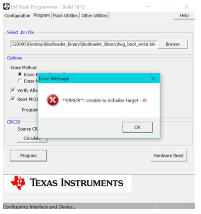

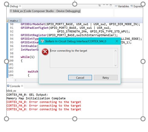

I am using  EK-TM4C129EXL. eval board. My evaluation board is not detecting and showing "error connecting to the target" while using CCS.
I have followed all the solutions from below mentioned thread, still its not working, my device manger shows the drivers. kindly help me to resolve this issue at the earliest. thank you.

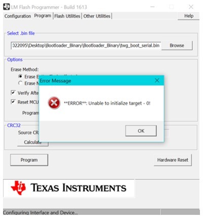

    on lm flash programmer
    on CCS while I tried to debug.
    I tried with blinky example from the standard library.

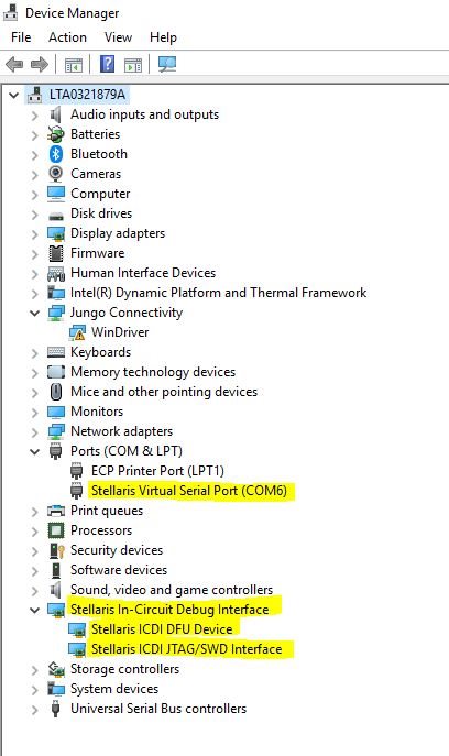

     Have you tried using another PC computer? I want to make sure if the problem is with the board or with Windows driver. Do you see the Stellaris In-Circuit Debug Interface like below in your device manager?
