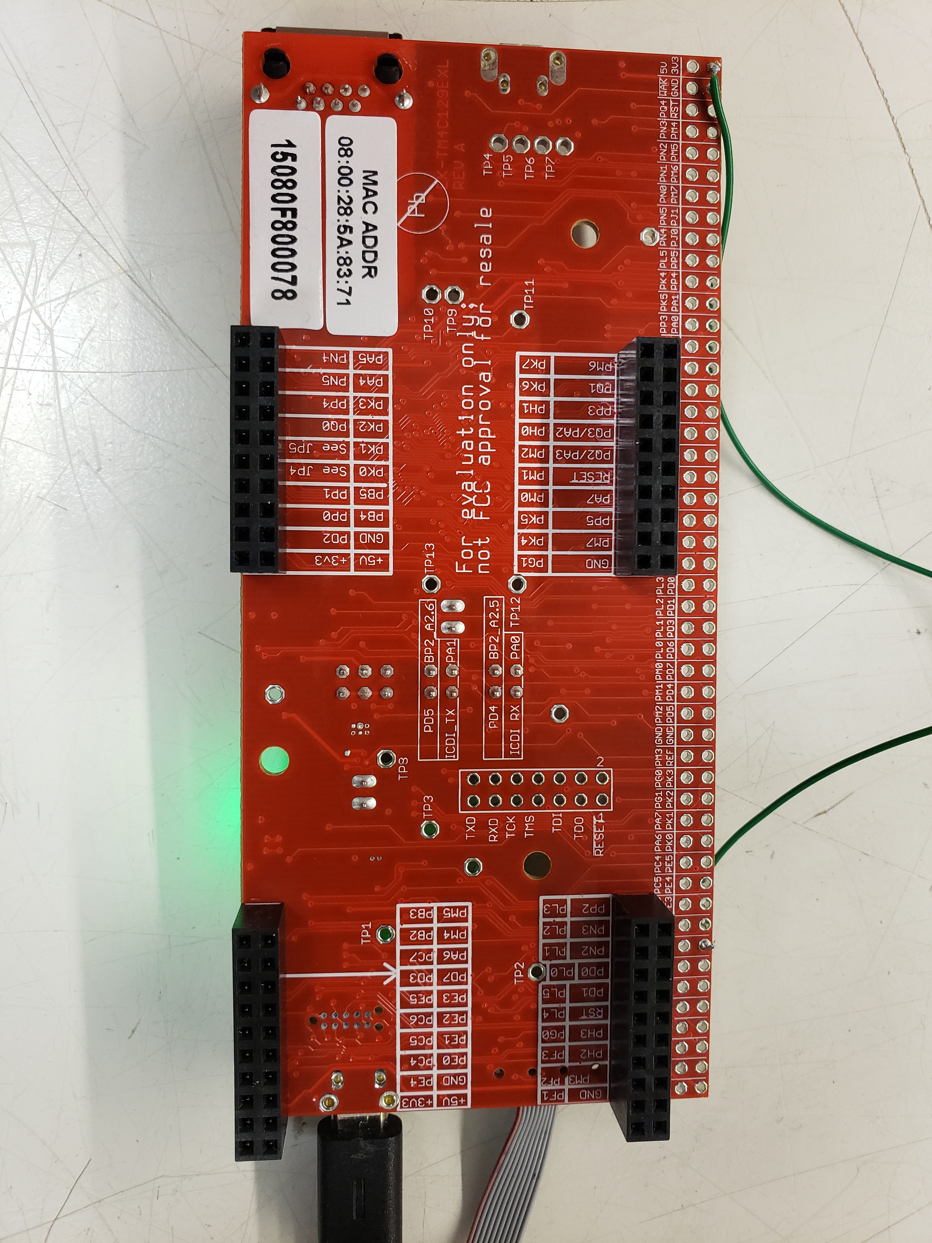

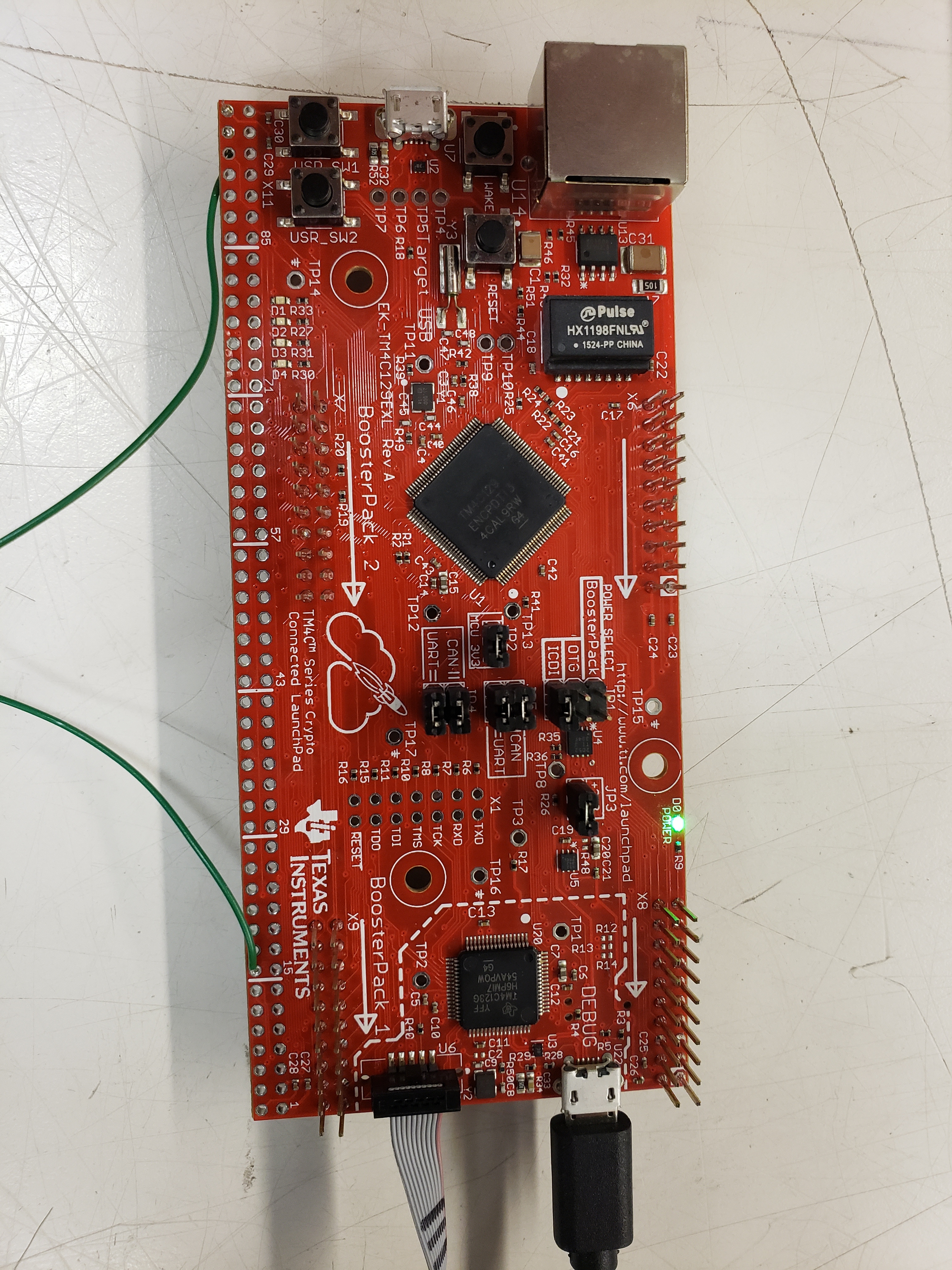

I'd appreciate some help getting my ADC off the ground using Tivaware and the pinmux tool outputs. Presently, I see no variation in my output (adc_buffer) in the expressions watch window when set to continuously refresh. I've tried to follow the example from "Creating IoT Solutions with the Tiva C Series Connected LaunchPad Workshop" with minor modifications to fit my program structure. Any advice?
