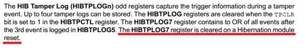

If we turn off the device one more time, enter hibernation mode and activate only one tamper than register HIBTPLOG7  will be without changes and it will look like both tampers have been activated (see Picture 1).
In case we want to clear these bits we should do next according to datasheet: (see Picture 2)
QUESTION: How can we reset bits of HIBTPLOG7 without restarting whole HIB module?

    Unfortunately from another page of the D/S this is stated:
    Note: The HIBTPLOG7 register is sticky and is only cleared by a Hibernate module reset.
    So that means there isn't a way to clear it outside of resetting the whole module. Sorry that there is not another way. But this design in general is to protect the device from having evidence about tampering erased.
