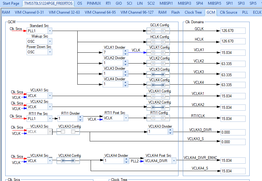

I am using a TMS570LS1227 in an embedded project. I am using FreeRTOS V8.2.0 on it.
The project is basically composed of 3 tasks:

The issue I am facing is the following: everything worked well for a while (I could send parameters from the PC, they were written in the EEPROM. No problem after power-off: paramaters were correctly read in EEPROM and data persistance was OK)
But yesterday, it suddenly stopped working: the Ti_Fee_WriteSync function did not work anymore (stuck in module state= BUSY). This happened on a PCB home made board. I tried the same code on the evaluation HerculeLaunchpad, and same result: working well for a while, but after multiple write of the parameters, Ti_Fee_WriteSync broke.
I was loading the program using CCS, with the option in the "debug" tab specifying to not erase FlashBank 7, in order to keep my parameters saved between 2 program load.
Problem was solved by resetting this paramater to erase all flash sectors, but this is not satisfying: I want the product to be usable without having to reflash the code to "repair" the flash...
I have absolutely no idea of what is hapenning here.
Last pieces of information, in case it helps:
- interruptions (gio, uart rx) can trigger while the SyncCom task is performing read/write operation in EEPROM. however, this task is the only one to access EEPROM.
- for spi issue reasons, i had to down the VCLCK1 by increasing divider to 7.
attached the corresponding halcogen configuration
