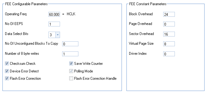

I'm getting the error code Error_InvalidBlockIndex after calling TI_Fee_WriteAsync(BlockNumber, &SpecialRamBlock[0]);
My configuration:
