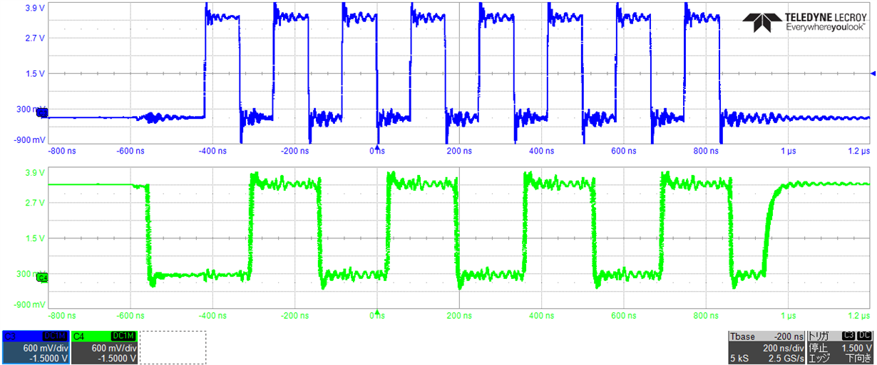

I have a question about timing in QSSI slave mode.
The data sheet specifies that the minimum timing of S11(TXDSOH) is 37.4ns, however it seems that S11 is output in about 22 to 33 ns in actual measurement.
TM4C1294 is used in Freescale SPI Frame Format with SPO=0 and SPH=0 at slave mode.
The measured waveform is attached below.
- TSYSCLK = 120Mhz
- SSI2Clk(4 pin): Blue
- SSI2TX(2 pin) : Green
- The SPI transfer rate is 6Mbps, and the slave outputs 0x55.
The figure below expands the third falling clock edge.
The figure below expands the fourth falling clock edge.
Although the measurement results are less than the data sheet specifications, are the data sheet specifications correct?

  • Interesting. It looks like the 37.4nS should have been the maximum delay (at 120MHz). The minimum looks like 2.5 cycles. I will need to look into this. Since most SPI implementations don't require a hold time on the changing edge, is this timing critical in your design?

  • Sorry for the delay. We think the timing in the datasheet is not correct and what is listed as a minimum time is indeed a maximum time. Still working on the minimum time. It looks to be about 16.5nS (at 120Mhz). What we plan to do is add this to the next publication of the errata document SPMZ850. I don't know when the next release of that document will be, but I can create a draft version with the added advisory once we nail down the true minimum time.
