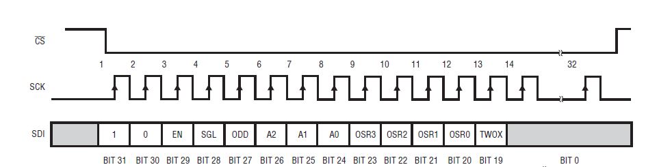

  • Hi sir,
    I changed the code based on your previous reply and I am able to send the channel number correctly. But I am unable to get any output data from the ADC.
    The below mentioned are the correction I did based on your reply.
    CS pin  low for the 32 bit data transfer. The FSS pin configuration I changed and so chip select is now working fine.verified with an oscilloscope.
    I am able to send the channel number correctly. Verified the output of clock and data input(SDI). It came perfectly. But I am unable to read data output(SDO).some noise signal is coming from the data output.
    In the debugger mode  some hex value came once and then getting Zero continuously.The hex value what I got is  invalid data.
    I am not able to take the snapshot from scope. so I am attaching the signal format I observed in the scope.
    I am not understanding how to check the EOC bit status.Please explain how we can check EOC.

  • That is really a question for the makers of the LTC2442, not for me. If I understand their datasheet correctly (and I am not familiar with that device), you take the chip select low and then read the SDO pin (serial data out). If the pin is low, then you can start the 32 bit SPI transfer which will read the previously converted result and can set the channel for the next conversion. When you take chip select high, it starts the next conversion.
    You can read GPIOA PA4 as a gpio pin even though it is configured as SSI0RX and poll that pin until it goes low. Then start the 32 bit SPI transfer.
