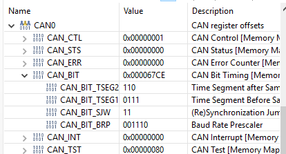

  • Have you tried using the default timings for 500K baud. If you call
        CANBitRateSet(CAN0_BASE, ui32SysClock, 500000);
    without calling CANBitTimingSet(), (assuming ui32SysClock is 120000000) you get these settings:
  • Hi Bob. Thank you so much for the fast response.
    I checked the values of the CAN_BIT register and they are the default ones, as in the picture you showed.
