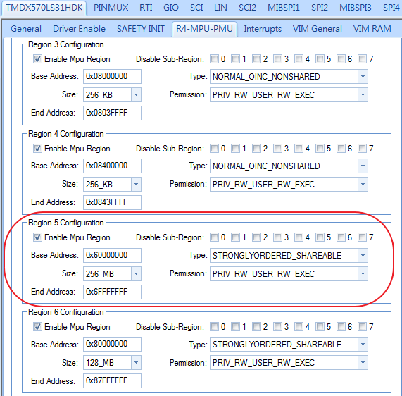

I use TMS570LS3137's EMIF to attach a Cypress S70GL02GS flash device.
When I write a single 16-bit data to a specific location with halfword or word alignment,
I saw redundant write EMIF_nWE pulses by oscilloscope.
I tried work around tips that set EMIF regions as 'device' or 'strongly ordered' MPU memory types,
fully compliant with SPNZ195G EMIF#4. But Extra write pulses still appear.
The following picture shows one of recommended MPU settings for EMIF async. regions.
How can I remove extra write pulse without additional logic combines the EMIF_nWE with
EMIF_nDQM1 and EMIF_nDQM0 ?

  • Mason,
    Either device type or strongly-ordered type configuration for the external memory will work. Can you please make sure that the CPU's MPU is actually getting configured and enabled? There should be a call to the mpuInit() function.
    Sunil
  • Hi Sunil
    It's really the root cause that my code didn't call _mpuInit()_ to initialize MPU.
    The HALCoGen 4.7.0 don't call this function automatically during startup procedures.
    With the indication you pointed out, now EMIF works without extra write pulses :)
