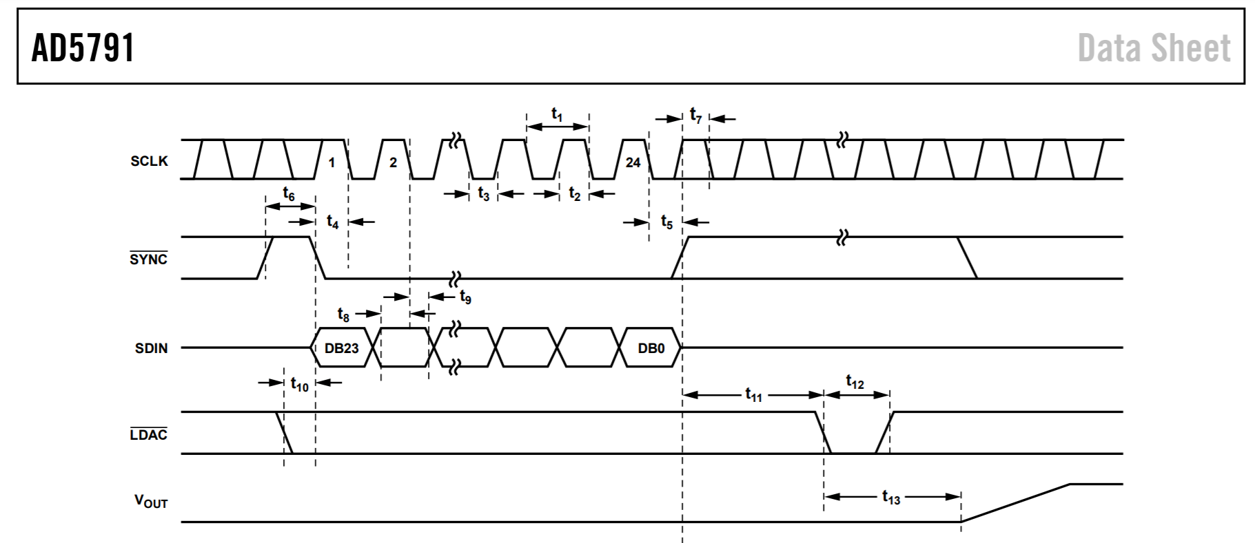

  can anybody suggest how to send 20 bit data to DAC ad5791 from microcontroller tm4c129xnczad . i saw in ssiconfigsetexpclk take only 4 to 16 bit data. please tell me how to do this
  • It looks to me like the AD5791 requires a 24 bit transfer.
    You can do this by manually toggling a GPIO pin low to start the SYNC and then do 3 8-bit transfers then set SYNC high. Or you could use the SSIAdvFrameHoldEnable() function to manipulate the FSS signal to do the SYNC function.

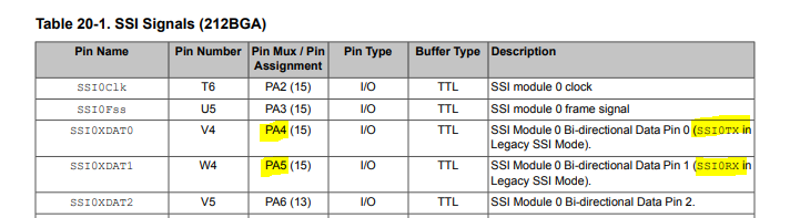

  • You have the TX and RX pins mislabeled. Do you have them wired correctly? PA4 is TX and PA5 is RX.
    Also, don't use SysCtlClockGet() function with the TM4C129x devices (line 102). That function is only for the TM4C123 devices. Use the variable ui32SysClock instead.
  • yes i have hardwired it correctly and i am observing at oscilloscope too but output is 0v on any input
  • thanks for your great help
    the problem sorted out
