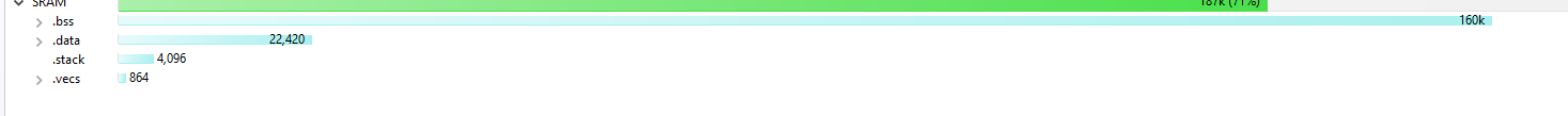

I do want to trace the sysmem usage, because on some occasions I lose all my dynamic memory, and I do not know why. (the free list pointer has less than a 100 bytes).
what I define, what I see in the memory allocation
CFG:
BIOS.heapSize = 18000; // bios heapmem
Program.heap = 40000;
Program.stack = 4096;
memory allocation:
ti_sysbios_heaps_HeapMem_Instance_State_0_buf__A 18000
.sysmem 40000
.stack 4096
CFG:
BIOS.heapSize = 40000; // bios heapmem
//Program.heap = 40000;
memory allocation:
ti_sysbios_heaps_HeapMem_Instance_State_0_buf__A 40000
.sysmem 4096
.stack 4096
CFG:
//Program.stack = 4096;
memory allocation:
.sysmem 4096
.stack 4096
CFG:
//BIOS.heapSize = 40000; // bios heapmem
memory allocation:
.sysmem 40000
.stack 4096Embedded.cfg
