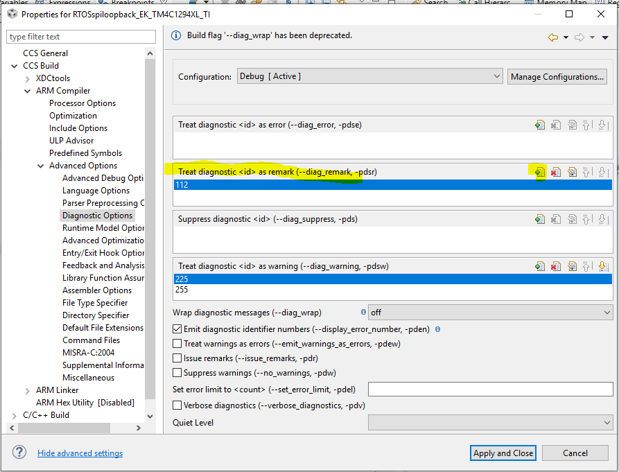

  • If you don't want that warning you can disable that message or turn it into a comment only adding 112 to the section for "Treat diagnostic<id> as remark" or the section "Suppress diagnostic <id>". You can do that for the whole project by right clicking on the project and selecting "Show Build Settings.." or you can change this for an individual C file by right clicking on that file and selecting "Show Build Settings...".
  • I tried as u suggested. But still warning appears as it was.

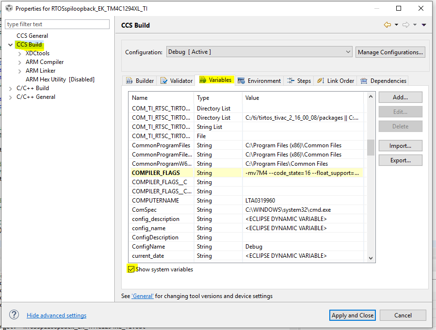

  • Not sure why that did not work for you, it worked in my setup. Another option is to edit the variable "COMPILER_FLAGS" and add the string "--diag_remark=112". This variable is used for setting compile options for the XDC generated code.
    Right click on the project, select "Show Build Settings...". Click on "CCS Build". Select the "Variables" tab and check the "Show system variables" check box on the bottom. Scroll down to the variable "COMPILER_FLAGS" and select it. Now click on "Edit". Scroll to the end of the string and add "--diag_remark=112". Select "OK", the "Apply and Close".
