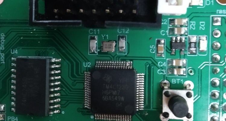

Hello Minh,
I don't think that's a code issue, it could be a hardware issue. Can you post schematic and also a picture of the MCU & XTAL so I can see how close they are etc.?

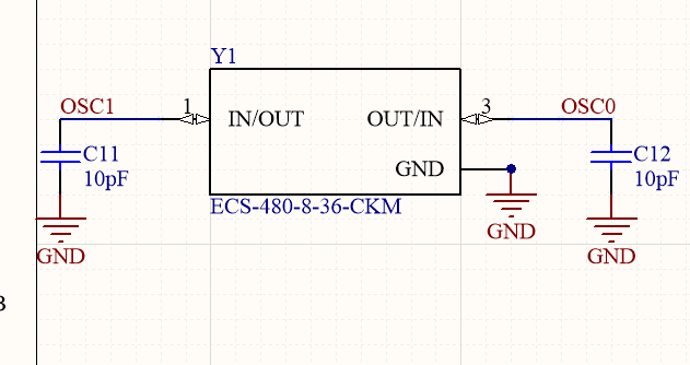

This is my schematic. is there a problem in schematic that affect the PLL?
Could you give me some idea, please.

Hello Minh,
According the datasheet for your crystal, the ECS-480-8-36-CKM is a 48 MHz crystal, not a 16 MHz crystal: https://www.ecsxtal.com/store/pdf/ECX-2236.pdf
See the Part Numbering section on the bottom of the first page.
See if you can get a 160 version of that crystal maybe.
Or from ECS we have tested the ECS-160-9-42-CKM-TR. It has a different package size though so you'd need to change your PCB a bit.
oh, I am sorry about the schematics make you misunderstanding. But I am sure that i used the 16Mhz XTAL not 48 Mhz.
I were a bit lazy when i made this board. so i use the 48Mhz and forgot to change the name of that XTAL.
i am apologize for my negligent.
