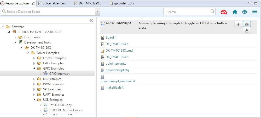

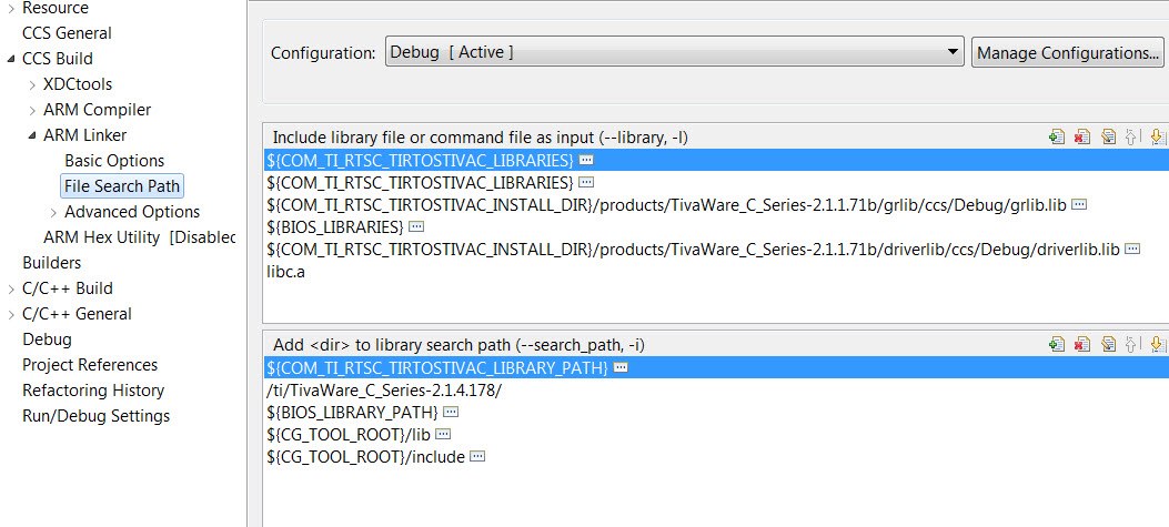

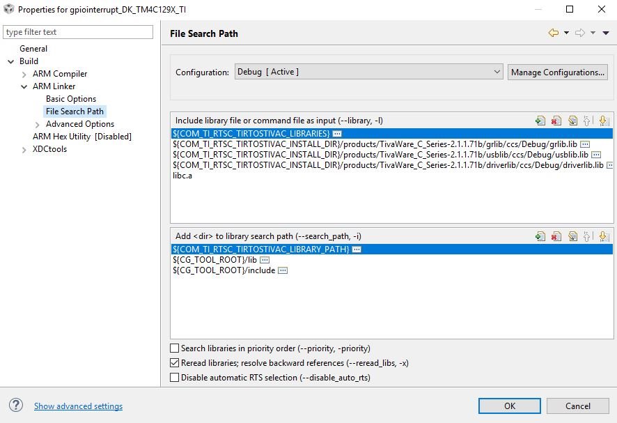

I started bringing up my board using the simple task project, which runs fine. I'm now trying to start blinking an LED by cutting and pasting code from the usbserialdevice_DK_TM4C129X_TI example. When linked the GPIO_init symbol is undefined. I've looked through the USB code but cannot find the #include needed. Code and linker data:
