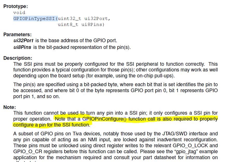

Can anybody solve this for me. The problem is with the GPIOPinConfigure command. Is it necessary to use the command, because I have previously initialised the SSI 0 peripheral and also configured GPIO port A as SSI pins. Do I have to use the GPIOPinConfigure function again ? Isn't it redundant ? If not what is the correct way to ensure the operation ?

int main(void)
SysCtlClockSet(SYSCTL_SYSDIV_2_5|SYSCTL_USE_PLL|SYSCTL_XTAL_16MHZ|SYSCTL_OSC_MAIN);
SysCtlPeripheralEnable(SYSCTL_PERIPH_GPIOA);
while(!SysCtlPeripheralReady(SYSCTL_PERIPH_GPIOA))
SysCtlPeripheralEnable(SYSCTL_PERIPH_SSI0);
SysCtlDelay(3);
GPIOPinTypeSSI(GPIO_PORTA_BASE, 0x3C);
GPIOPinConfigure(GPIO_PA2_SSI0Clk); ??
GPIOPinConfigure(GPIO_PA3_SSI0Fss); ??
GPIOPinConfigure(GPIO_PA4_SSI0Rx); ??
GPIOPinConfigure(GPIO_PA5_SSI0Tx); ??

And the error message as displayed
"../main.c", line 31: error #20: identifier "GPIO_PA2_SSI0Clk" is undefined
"../main.c", line 32: error #20: identifier "GPIO_PA3_SSI0Fss" is undefined
"../main.c", line 33: error #20: identifier "GPIO_PA4_SSI0Rx" is undefined
"../main.c", line 34: error #20: identifier "GPIO_PA5_SSI0Tx" is undefined
