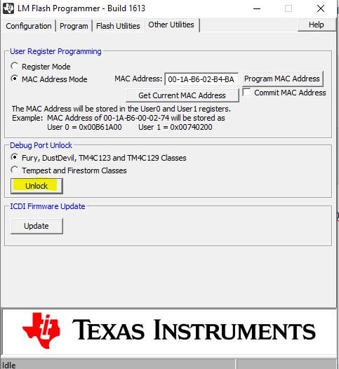

      If you simply try to download code via the JTAG to the MCU (not the ICDI) then it should not corrupt the ICDI. Perhaps the problem is not with the ICDI. It may have something to do with the the MCU running your updated code. Normally, the device can get locked out from debug access if code intentionally re-purpose the JTAG pins for GPIO usage. Or the device is intentionally put into sleep mode. Do you remember if your code is doing as such? In LM flash programmer you can do an unlock of the device. Have you tried like below?

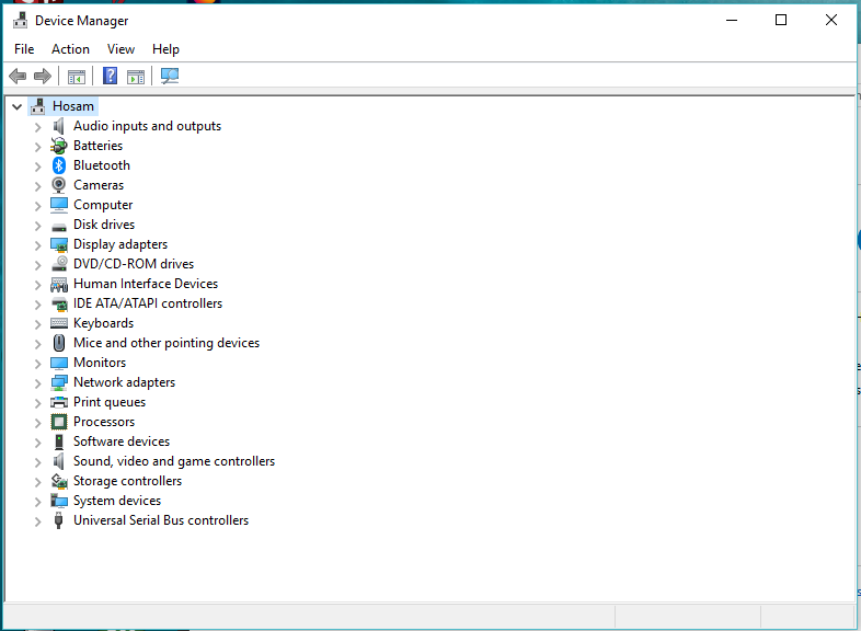

  • Can you also show your device manager from Windows?
  • This is the device manager and the configuration of the board and you can see that the last code is up and running.
  • ok, thanks. I think your MCU is still good. When you tried to update the ICDI firmware with an older version that might have cause the Windows not able to enumerate the board anymore. My recommendation is still for you to try updating the ICDI firmware again with the latest version of the LM flash program and see if you can recover it. There is no guarantee on this.
