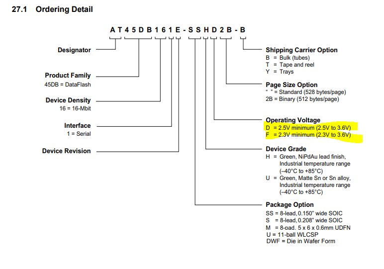

  • Interesting. Mouser shows over 2,000 available and the datasheet does not indicate the part is no longer recommended for new designs.
  • Here is a list of parts still active: https://www.digikey.com/products/en/integrated-circuits-ics/memory/774?k=AT45DB&k=&pkeyword=AT45DB&sv=0&pv7=2&sf=0&FV=1f140000%2Cffe00306%2C23805e0%2C23805e3&quantity=&ColumnSort=0&page=1&pageSize=25
    It looks to me like they are discontinuing the -SHD (2.5V to 3.6V)  option for the -SHF option (2.3V to 3.6V). It makes sense since the -SHF parts have a wider operating voltage range.
    You can contact Adesto for verification.
    You can use other SPI serial flash devices, but they may require some software modifications.

    Is this chips something that could be “easily used” with the Tiva and TI ROTOS by just modifying some #defines or should I find another part that would be a better fit?
    Doug
  • Todd,
    Doug and I met up today to talk more about this.  The Atmel device substituted for the original memory TI selected for this, which has since been labeled
    'not intended for new designs' is not a drop-in memory device from a software perspective.  Doug has confirmed that.  We suspect the memory partitioning and sectoring in general are different, therefore, not a drop-in.
    Has your team done work with any other substitute memory devices that you can suggest to Doug, or frankly other customers in the same predicament?  We would welcome any input you can extend.  We realize this is memory and not something TI manufactures themselves, but we are hopeful from a TI-RTOS and overall project standpoint, that your team can provide some additional guidance.  Ultimately, we want to find a larger memory density device to the original, that provides as close to drop-in as possible, or at least with identifiable changes to the RTOS project and corresponding software.
    Thank you,
    Chris
