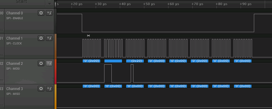

Getting waveform as Below :

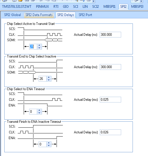

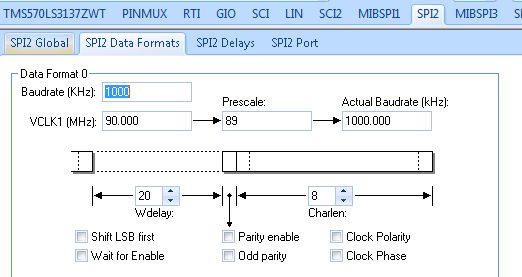

Halcogen settings

2.Even though we added a Wdelay of 20 in data Format, no effect in output SPI signal.
3.Chip select active to transmit start made 300 ns and transmit end to chip select inactive 300ns no effect in the waveform.
